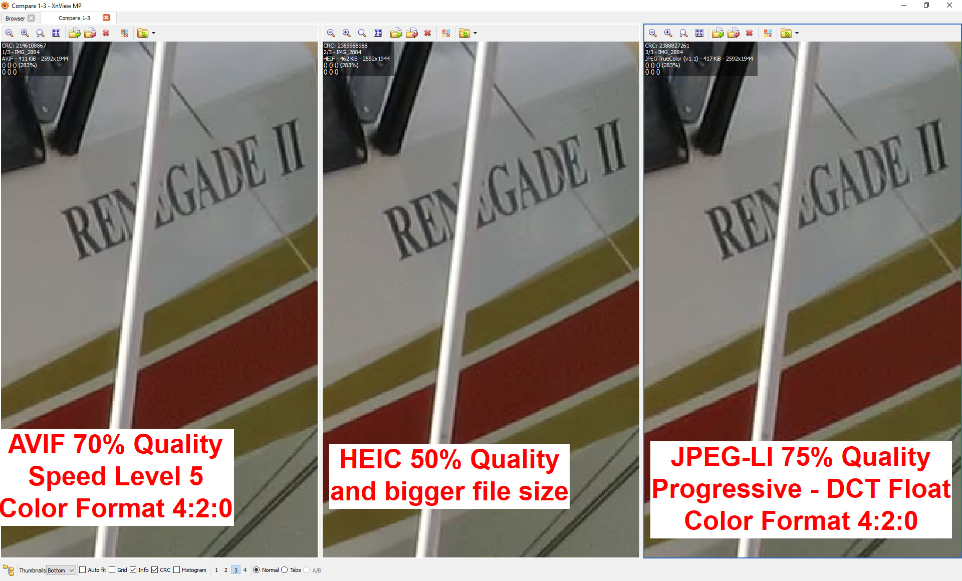

Here is an example file, which was encoded by avif (Quality 70% - color 4:2:0), heic (50% Quality) and JPEG-LI (75% Quality - 4:2:0 color format - progressive). I used these settings to get an nearly equal filesize.
There are only a few quality differences. AVIF can better handle flat textures and text edges look sharper.
But the JPEG-LI encode looks great and has a very good speed/compression behaviour.
AVIF compression tooks up to 5 times more.
My recommend setting for JPEG-LI is min. 75% quality (better 80% if save space is not important).
Progressive format is a bit slower and has lower filesize than JPEG Standard (=baseline).

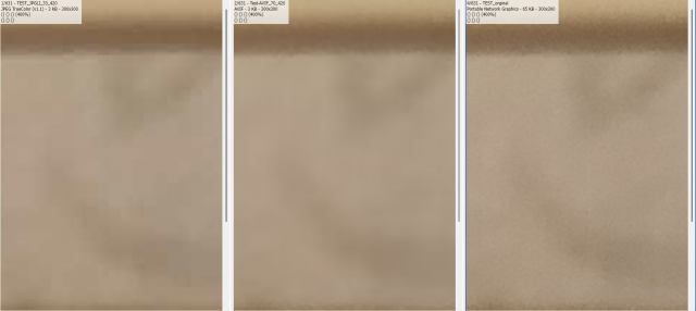

If you want profits greater than 35%, you need to know what you lose. In the picture below you have on the right a test image PNG; in the middle AVIF with 70% quality; and for the same file size, on the left there is an image in JPEGLI with 33% quality. When watching in 100% zoom comparison is not bad, the copies are quite similar to the original. But what do we see after increasing to 400%? AVIF has completely lost noise/granularity. JPEGLI, like JPEG, also blurred the picture, but also clearly you can see squares.
You will receive distortions, wanting saving too much space. However, from this two evil, I will choose AVIF.
If you want to keep photography nuances, buy a larger disk and compress (or not) it to JXL not less than with 95% quality. Soon all software will be known jxl format.

I must say that majority of my collection is pretty bad pics (mobile phone) and avif works very well as it removes also noise. AVIF algorithm seems particularly good for pics with have a lot of dark/black.
It might be different playground for somebody that has only high quality DSLR material.
I tested also JPEG LI but I got worse quality results than normal JPG. I am not 100% sure if i used the right settings but I tried to respect the ones that were written above.
And it consumes much more space than AVIF or JXL so I don't really like it.

AVIF has fantastic compression, but you need to test it on your android device!
On my Samsung S10 with Android 12 I have big problems with the samsung gallery app.
It only supports AVIF files with color format 4:2:0.
I tested this format with 70% quality and with portrait photos I had small but annoying color differnces.
The skin tone was much darker than on the original jpeg photo.
If you use fossify gallery on android, the avif decoder can handle it perfectly.
Maybe on your Samsung S22 the quality is better. Please try it, before you convert all your photos!
Check the colors.
WIth XnViewMP the avif files are viewed correctly, so you can not check it on windows/linux systems.
Check the colors.

Sorry, I did not answer.
My prefered settings for JPEG-LI are:
