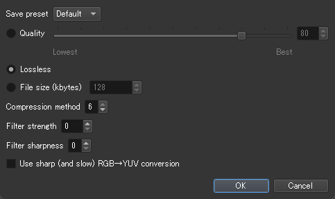

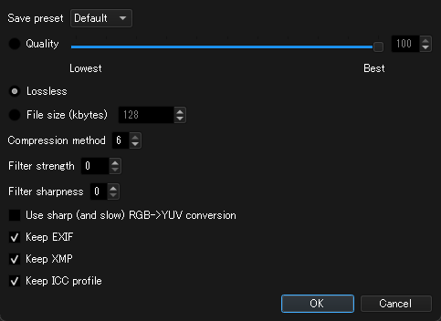

Configure the batch conversion settings to aim for lossless compression and maximum compression efficiency.

XnView use 75 (default) as quality when you use lossless

Re: WebP Compression Error in XnView MP
no there is a little difference between cwebp and XnView (header size) but i don't understand why. I use same options. I need more investigation
Correction in Measurements and Observations: Upon re-measuring, the file size for xnviewmp1.8.6(webp) should be 1,035,360 instead of 1,035,359. This confirms that xnviewmp1.8.6's lossless setting is fixed at -q 75.
To investigate further, I ran cwebp.exe with the parameters -lossless -m 6 -f 0 -sharpness 0, without specifying -q. Interestingly, the resulting file size matched xnviewmp1.8.6's lossless setting (-q 75). This suggests a potential shift in the lossless configuration:
・For versions up to xnviewmp1.5.5, the lossless setting may have been consistently [-lossless -q 100].
・In xnviewmp1.8.6, the parameter appears to rely only on [-lossless].

It states here that it can be used for both lossy and lossless compression, and if aiming for maximum compression, you should use -q 100.
Key Points
・If the hypothesis is correct, in version 1.8.6, the lossless parameter might be limited to [-lossless] only.
・To restore the previous setting, it might be necessary to revert to [-lossless -q 100]
