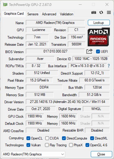

lphilpot
- Posts: 105
- Joined: Wed Oct 05, 2016 2:49 am
Re: atio6axx.dll crash after exiting video viewer
Those are the minidumps -- C:\Windows\minidump\*.dmp. But it's not creating one, nor a full size C:\Windows\memory.dmp. It just vanishes. I was hoping my XnView MP wrote its own log.Alexandra0056 wrote: Wed Jul 30, 2025 6:39 pm Crashes usually automatically create .dmp (Crash dump) files on Windows.
However, I have AMD CPU / GPU as well with Radeon graphics.
Len Philpot
