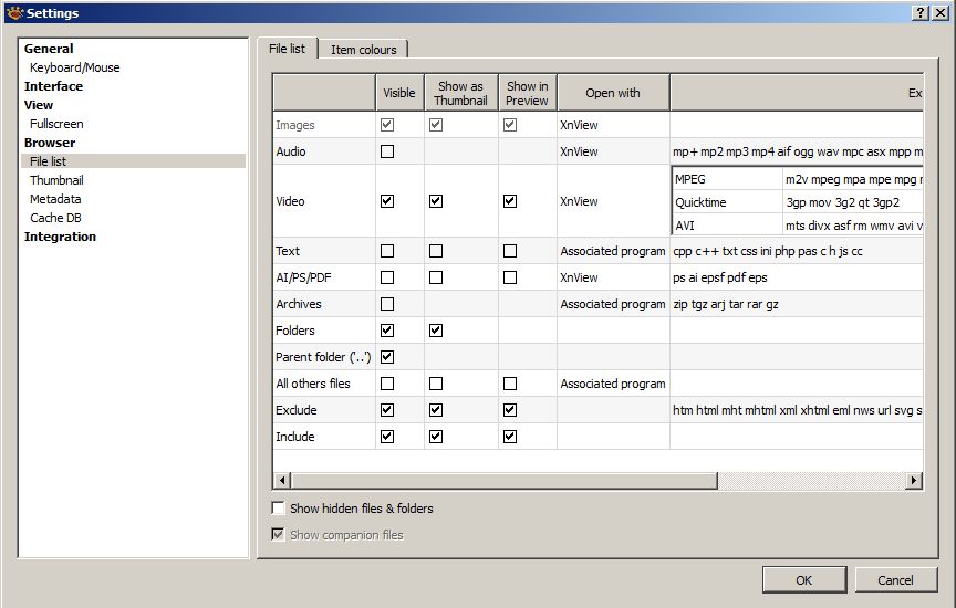

I found out that a crash happens with certain directories, when Settings - File List - Exclude (all sort of html stuff..) is unticked! So tick the 3 checkmarks there and see if it crashes...
I can easily reproduce this problem...
For some reason I also get a crash when browsing to XnViewMP-folder with attached selection in File List...

vilisov wrote: For some reason I also get a crash when browsing to XnViewMP-folder with attached selection in File List...
Confirmed all. XnView.db causes crash in old-style thumbnails view. So does v.1.97's category.db and website.url

Occasionally, restarting program in last-used folder revealed problem for me. Yes, I think content of file matters also. A jpeg misnamed "jpg.db" was displayed. A text file misnamed "image.jpg" was troublesome in thumbnails view. I did not notice v.1.97 features like 'recognize by extension' or 'ignore error' in options yet.
