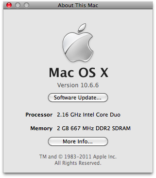

I am running Mac OS X 10.6.6 on the original Intel-based Macbook Pro 17"

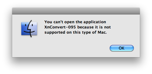

I did run into a problem with the Mac version. I downloaded both XnConvert-mac.dmg and XnConvert-mac.tgz from the "XnConvert beta 0.95" announcement. The app contained inside either compressed file has a circle-slash through the icon, and will not run on my Intel-based Mac.
Upon running the app I get two popup error messages that say, "You can't open the application XnConvert-095 because it is not supported on this type of Mac." When I click OK on both popups they go away and the app never opens. I have attached the error, the Finder Get Info panel for XnConvert-095, and the "About this Mac" for my Mac.

XnViewMP 0.35 does function on my Intel-based MBP 17". However, XnConvert 0.95 continues to refuse to load on my Mac--still reporting, "You can't open the application XnConvert-095 because it is not supported on this type of Mac."

Ok, 0.95 was 64bits, and 0.98 32bits...rbarker wrote: Good news is, I just tried XnConvert 0.98, which loads well on my Mac. I look forward to taking a closer look at it in the coming days.
