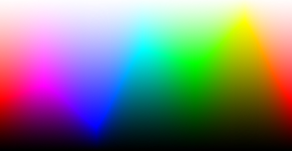

File size           94.87 KiB (97.143)
Format              JPEG TrueColor (v1.1)
Width               580
Height              300
# of bits           24
Color model         RGB
DPI                 72 x 72
Print size          20.46x10.58 cm, 8.06x4.17 inches
Compression         JPEG
Progressive mode    No
Sub-sampling        1x1,1x1,1x1
Estimated quality   100
Images/frames count 1
Origin              Top-Left
File size           55.25 KiB (56.580)
Width               580
Height              300
# of bits           24
Color model         RGB
DPI                 72 x 72
Compression         JPEG
Progressive mode    No
Sub-sampling        2x2,1x1,1x1
Origin              Top-Left
BTW: A chroma subsampling ratio of 1×1,1×1,1×1 = 4:4:4 = full horizontal + vertical resolution = no sub-sampling

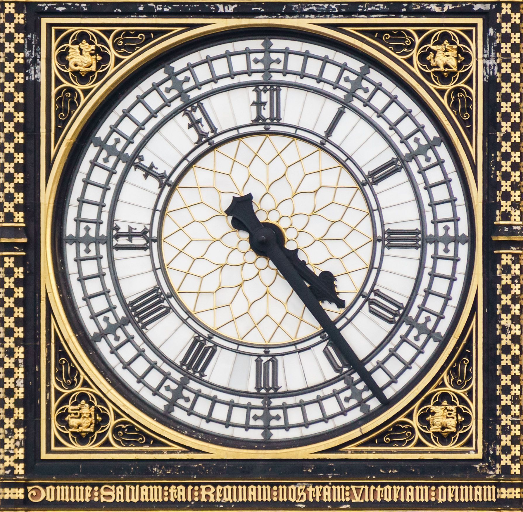

I have now performed a test to find the answer: I selected an image having a high level of detail, in particular straight edges that would be most likely to reveal the predicted loss of detail after being resaved many times, a clock face.
I first saved a downloaded clock face image in XnView MP at Q=80, then used a batch file to save the resulting image to a new file, then saved the resulting image to a further image, and so on until the original high quality image had been resaved a total of 10 times. All saves were made at Q=80 as above, using the following code:
It would be expected from the discussion above that an image resaved 10 times would show a substantial loss of quality, the calculated Q=0.107 value would be a very low quality setting, so how did the final image compare with the original image? Was there indeed a substantial loss of quality?
The image below s0 is the original image that was resaved 10 times:
[s0]
The image below s10 is the same image after being resaved 10 times at Q=80:
s10
s10
Compare the two images, is the lower image obviously quite unusable as predicted? For easier comparison, save each image, and then open the two images in adjacent tabs in XnView MP. Then if you like, zoom in and lock the zoom in each image for a really close comparison.
Zooming in, it is possible to see some slight loss of quality, but doesn't the image above remain quite usable for any reasonable purpose?
Details of the two images are: Width 1789px, Height 1752px, DPI 240 x 240, Sub-sampling 2x2, 1x1, 1x1 and 'Estimated quality' 80.
Those file properties are as displayed in XnView MP 'File information', which displayed the second image as still having Q=80...
Although the original file was selected for its high level of detail, the reasonably large image pixel dimensions are probably favourable for maintaining quality. A slight improvement in the output image quality might be expected if sub-sampling 2x2, 1x1, 1x1 were used. File size was very slightly decreased by the first save. The fact that all saves were made using the same software is probably relevant, in this case NConvert.

cday wrote: Sat Jan 23, 2021 7:56 pmCompare the two images, is the lower image obviously quite unusable as predicted?
While the (loss in) quality may be acceptable to you and me, most serious photographers probably wouldn't agree.
cday wrote: Sat Jan 23, 2021 7:56 pmI selected an image having a high level of detail, in particular straight edges that would be most likely to reveal the predicted loss of detail after being resaved many times, a clock face.
Remember that gradients are susceptible to colour banding caused by JPEG compression.
cday wrote: Sat Jan 23, 2021 7:56 pmFile size was very slightly decreased by the first save.
Assumingly because the ICC profile embedded in Big_Ben_Clock_Face.jpg @ Wikimedia Commons was discarded.

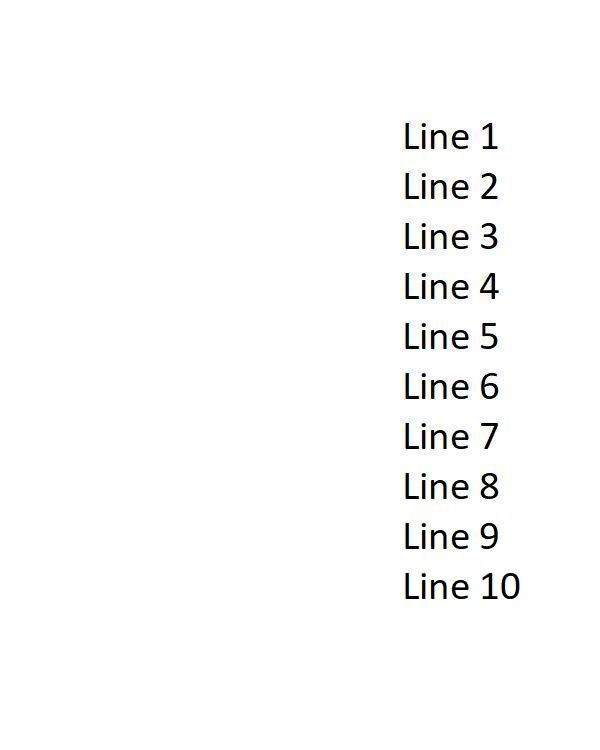

I was going to return to Peter2's problem, and to report the results of a further test I did yesterday. My test, in the same way as XnTriq's test above, wrote successive lines of text to an image, so that any perceptible loss of quality as the image was repeatedly resaved could be seen.
In my test successive output images were resaved as JPEGs, so the perceived level of quality loss in each resave is directly relevant to the discussion above as it has evolved, however the use in XnTriq's test of the PNG format as a lossless format for the intermediate images created is a valuable advance on best meeting Peter2's need.
This was the result of my test in which 10 lines of text were written successively with each resulting image resaved with Q=80 :
Writing text to an image of typical pixel dimensions in some ways isn't easy, as the number of pixels available to form the text characters will often be quite limited. At a quick look, the above result could be considered passable for general use, where it will be looked at quickly to read the text rather than critically examined.
Looking more closely, and especially zoomed in on the downloaded image, a slight but clear deterioration in the quality of the text characters can be easily seen, with typical JPEG compression artifacts in the form of faint 'smudges' outside the edges of the characters. The lines were written in numerical order from the top, so lines high up have been resaved more times than those lower down. On closer inspection a slightly lower compression setting would be better, though.
Another illustration of the possibilities and the limitations of JPEG resaving, but for Peter2's problem until multi-line text support is added to NConvert, XnTriq's use of PNG for intermediate lossless resaving is a valuable contribution. :D
This again illustrates that repeated resaving of a JPEG image does not inevitably result in a rapid loss of quality.

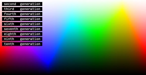

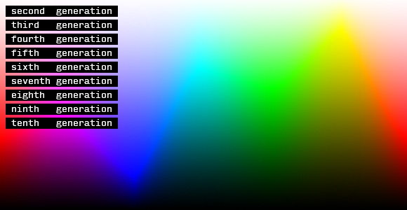

When an image is repeatedly saved with color subsampling, the bleeding will progressively increase because the chroma is interpolated on load into XnView and decimated again. I do not know about the command-line application. There would be little generation loss if the color was left "blocky , but it would usually look worse with natural images. Text and drawings could benefit from it and avoid the gamma error that occurs during interpolation leading to dark glow in extreme color transitions.
The Cambridge in Colour gradient does does not contain any detail to show the effect. But it is apparent around artificial text with color around it or other fine lines (such as the image that says "tenth generation").
5 and 15 generations with other software I made earlier, but the same library.
https://i.imgur.com/wzRB4BE.png
Ten gen with 80 4:2:0
