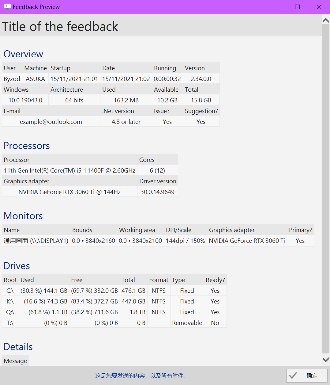

Yeah I got a better pc so it's faster...a little bit
btw this debug screen was generated by the in-app feedback button by screentogif

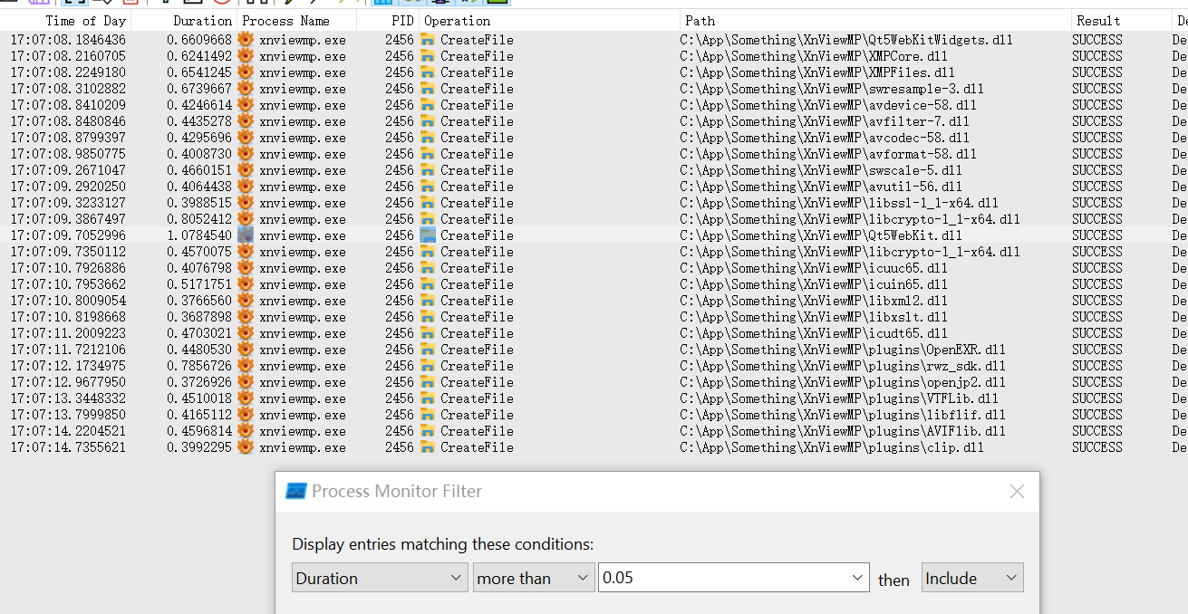

Thanks for the tool
TCPView didn't show any connection from xnview
promon shows that xnview takes tons of time loading some dlls
Here's the full log (this run takes 8 seconds btw):
Posts: 48895
Re: First startup after windows boot is extremely slow
it seems that libQt5Webkit is slow to load... And XnConvert delay? (it doesn't use WebKit)

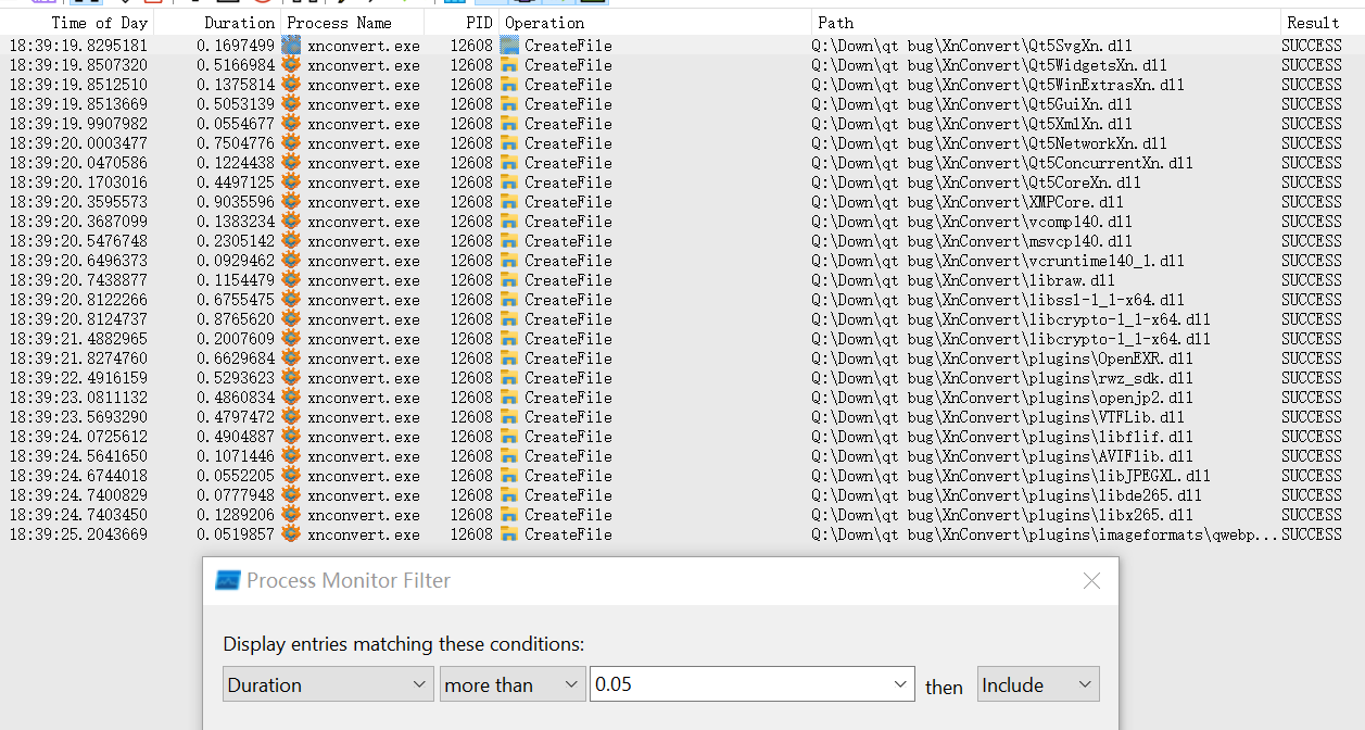

BK201 wrote: Tue Nov 16, 2021 9:40 amI didn't found xnconvert.exe in xnviewmp folder
XnConvert is a separate application which consists of XnView's batch processing engine (no view and no browse mode etc.). XnConvert is also based on Qt, but comes with less DLLs. v1.94.0 is the latest release.

7 seconds

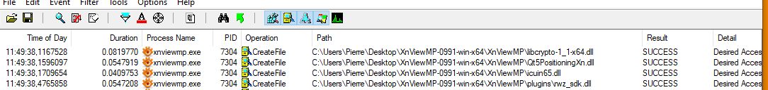

It's crazy, for XnView MP 64 bits after first startup
Windows 10 Pro (20H2): no big duration
Windows 10 Pro (21H1), slow device: no duration greater than 0.09
Do you have an anti spam and/or anti virus app?
