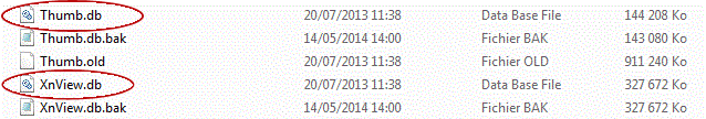

But I noticed yesterday a very amazing thing, I didn't before and can't explain.
Xnview.db and thumb.db are both still dated with 20/07/2013 !!! Even if size change (screen save below)
V2

It displays the Creation Date in that column. Since the file is the same (only the content was changed) the creation date is the same.

Hehehe... This is Windows.But I noticed yesterday a very amazing thing, I didn't before and can't explain.
Xnview.db and thumb.db are both still dated with 20/07/2013 !!! Even if size change (screen save below)![]()
