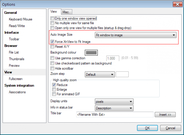

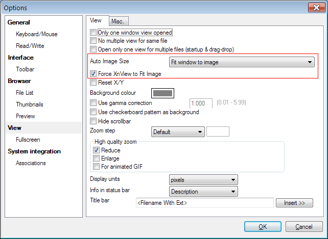

The video show exactly what you described. I said that I didn't use the Fit window to image option myself, and couldn't reproduce the effect when I tried. I have now produced some test images with different pixel dimensions, but initially still couldn't reproduce the effect.
I asked you to confirm that you had View > Auto Image Size set to Fit window to image but have now discovered that the relevant settings (plural) are in Tools > Options... :
Using the above settings I can now reproduce the cursor issue you described.
But is there a way to keep the cursor on the zoom icon while zooming? I'm sorry, I can't immediately suggest one myself, and doubt if there is one although I'd be happy to be proven wrong...

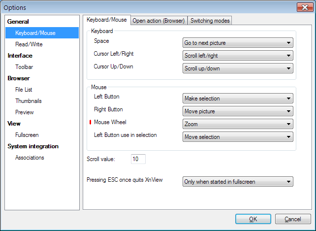

Wouldn't the best interface for your 'relaxed' viewing still be to zoom using the mouse wheel and to forward/back between images using the mouse buttons, if that was an available option? If this is likely to be a long-term need you could make a feature request to add those mouse button options, which would likely be quite easy to add... If your need is urgent, Pierre could possibly add them quickly in return for a suitable donation.
