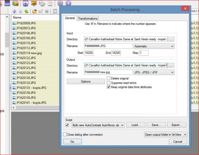

Thanks, i tried Tools-Sequence Converter. And i found and tried Tools-Batch Rename.
They do rename but i dont get them running any batch?!
In SC i have to select 1 file and cannot just select the whole directory. It also does not accept Ctrl-A command. I guess i have to do something with Start, Step and End?
Batch Rename auto-takes the directory but also processes only 1 file. I guess i here also have to do something with Start and Step?
When in SC i had 162001 entered in Start and End it only ran P1620114.jpg and nothing more.
When in SC i removed that last "1" in Start and End so there was only 1620 it only ran P1620009.jpg and nothing more.
It must be Start, Step and End settings but i dont get it yet...
Posts: 4623
Re: Batch Processing vs. Sequence Convert
XnView 'Sequence Convert' : this is a little used function and after looking at it myself I'm not entirely sure either how it is intended to be used, and whether it can process a folder of files; if you wish to persevere with it you could start a new XnView 'General Support' thread.
Edit: To use 'Sequence Convert' I think the files to be converted need to numbered consecutively, or with a constant 'Step' value, which doesn't appear to be the case with your files.
