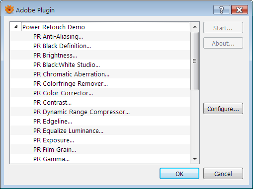

- Posts: 4601
Re: 0.78x64 (W 10x64) don't load the plugin Power Retouche
I've now got the filters working in both XnView MP 32-bit and 64-bit ZIP versions, so possibly a configuration sequence issue, but as I'm not very familiar with installing filters it is difficult to give advice...
However:
The common PowerRetouch Windows x32 / x64 installer extracts to separate filter PowerRetouch-RS822-DEMO-x86.exe and -x64.exe installers in the folder selected;
EDIT: Please read on to XnTriq's second post below for details of the recommended installation procedure for 8bf filters.
The relevant version should be placed in the XnView MP filters folder, if not already there;
When Image > Adobe Photoshop Plugin... is selected navigate to the plugins folder and then run the installer .exe placed there which extracts the plugins to the folder;
The installer instructions that appear refer to restarting [XnView MP] after the filters have been installed, after which they should become available for use...
This is the installer text for 64-bit version:
However:
I can't guarantee that the above sequence is exactly correct without reinstalling the filters to check...Make sure the installation path points to the Plug-Ins (or plugins) folder of your desired host application (ie. Photoshop).
This is the 64 bit version, so the path could for example be:
C:\Program Files\Adobe\Adobe Photoshop CC (64 Bit)\Plug-ins\Power Retouche
After installation start (or restart) the host application, and the plug-in should appear under the menu "Filter" under the sub-title "Power Retouch".

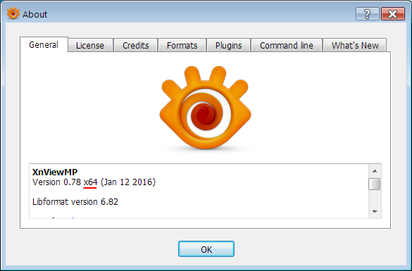

- Posts: 4601
Re: 0.78x64 (W10 x64) doesn't load the plugin Power Retouche
Did you restart XnView MP x64 after running the x64 plugin installer to place the files in the plugins folder?
I have it working:
I have it working:
