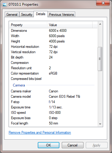

I've used ... -out jpeg -dpi 300 -keepdocsize -keepfiledate -overwrite -no_auto_ext ... to update my test image with success, kind of. I don't see an command to use with -keepdocsize that would keep the original size. When I convert my image from 6000x4000 72dpi it becomes 25000x16667 300dpi. What am I missing?

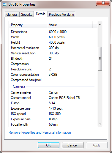

In the Windows GUI when resizing an image there are multiple options but specifically one to change the DPI and a checkbox for Resample with a select box for types (ex. Lanczos). I want to be able to do this with nConvert command line. Currently I can successfully change the DPI to 300 using:
However the file become massive going from 6mb to 16mb. If I exclude -keepdocsize from this command line then the file becomes 1.8mb. How do I keep the actual 6mb file size. I can do this in Photoshop but that isn't a batch solution I would use.

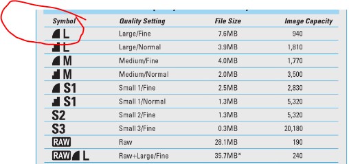

I'm referring to the quality/compression factor.jmann wrote:I'm not sure what the q-factor is.
I dug up a few unedited samples (6000×4000 pixels) shot with an EOS Rebel T6i.
According to JPEGsnoop, the specifications are as follows:
- Canon.Cs1.Quality = norm
Canon.Cs1.ImageSize = Large- Approx quality factor: 90
- Chroma subsampling: 2x1 ~ 2×1,1×1,1×1 ~ 4:2:2
- Canon.Cs1.Quality = fine
Canon.Cs1.ImageSize = Large- Approx quality factor: 97

Apparently, there's no exact match in Photoshop for Canon's “Large/Fine” (Q97 @ 2×1) compression schemejmann wrote:If related to an option in Photoshop when editing an image ... what would be related?
