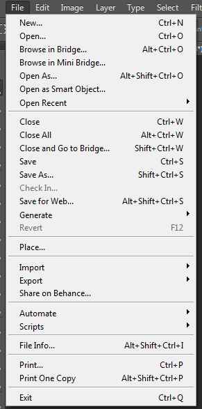

1. If would write "crt. file" would be ok for me.
2. It isn't too long. Because we have space and the meaning is clear. We have another very successful button "Crop, Save & Next". Also, one of the most used button in Outlook is "Save & Close". ...and don't get me started with Photoshop: (both captions and shortcuts...)
Photoshop file menu.jpg (24.67 KiB) Viewed 5066 times
Brevity is good but clarity is much more important.
