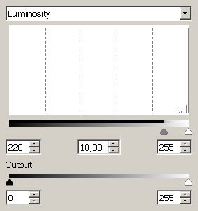

Method #2: Image → Adjust → Levels...

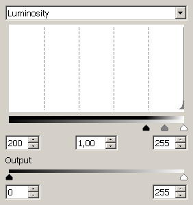

Combining Method #1 & #2:
- Image → Map → Automatic contrast
- Image → Adjust → Levels...
- Image → Change color depth... → Binary (Dithering: None)

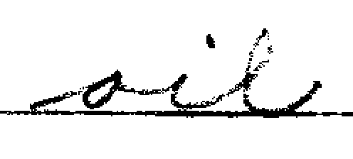

The downside of JPEG compression is the introduction of so-called artifacts:cooky wrote:when scanning recipes and if option is available would it be better to have image in png or another format rather than jpg
Reducing the color depth to binary (only two “colors”: pure black + pure white) or grayscale (256 shades of gray) helps to keep the file size down (if that's of concern to you).
As mentioned by cday, saving binary images to TIFF with “Fax” compression will result in the smallest file.
