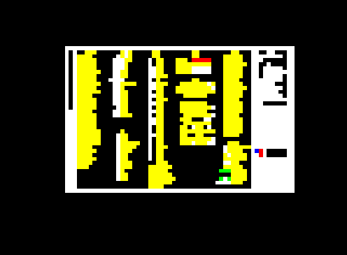

Sorry I could not upload the dwg file as this is project related. Attached is what I saw in both Browser and Viewer. I have the low resolution issue with all the dwg files, not just one. I checked the format and they are in autocad 2013 format.cday wrote: Tue Sep 25, 2018 7:07 pmImage viewers always ultimately display pixels!vren wrote: Tue Sep 25, 2018 6:46 pm I think XnView MP currently show dwg file as a picture in both browser and viewer, not as vectors, if you zoom in you will see the pixels. It would be good if there is a way to force it to show as a vector, otherwise is there an option to set the resolution?

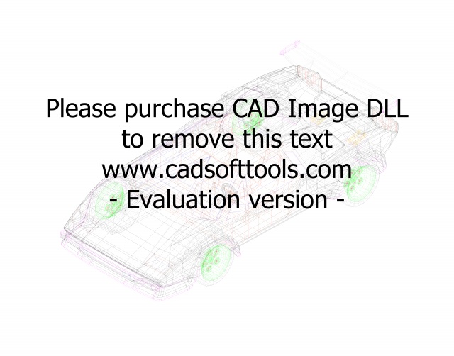

Initially I thought the XnView MP reads dwg file with its own dll, but after some trial and error, I found out that it is not the resolution problem, as what XnView MP displayed is the thumbnail that embedded in the dwg file, even in the viewer window! It did not show the content of the dwg file, so there is no resolution to change! I would suggest to display a message in the viewer window to remind user to install the plugin, so to avoid the confusion.
If you use the CAD Image DLL plugin, it works the same way as in XnView, unregistered version has a low resolution picture with blocked text, unless you upgrade to get the registered version.

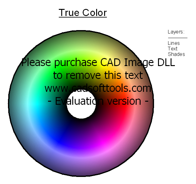

I tested and only 64-bit edition of CADImage.dll is compatible with 64-bit edition of XnView MP 0.92, not the 32-bit dll, which I think it's the right way that you need to match the dll with the version of XnView MP.XnTriq wrote: Sun Sep 30, 2018 11:00 am @cday & @vern:
