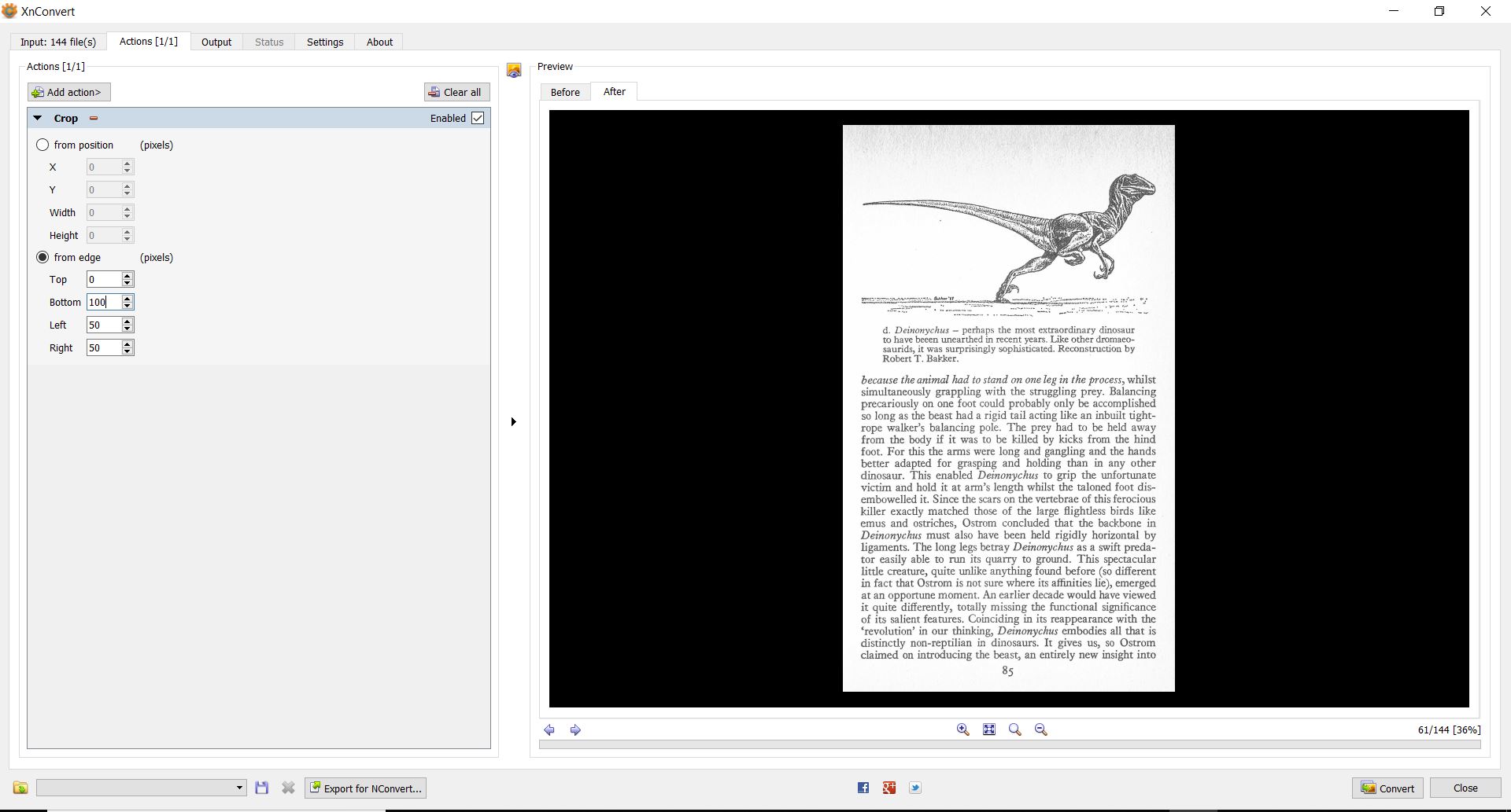

I opened the files in XnConvert Ver 1.79 x64, entered the cropping values and ran it using the Apply action arrow. Attachment #1 shows a typical page - note the Before tab is selected. Also note that the bottom RH tab says that it is file number 60.

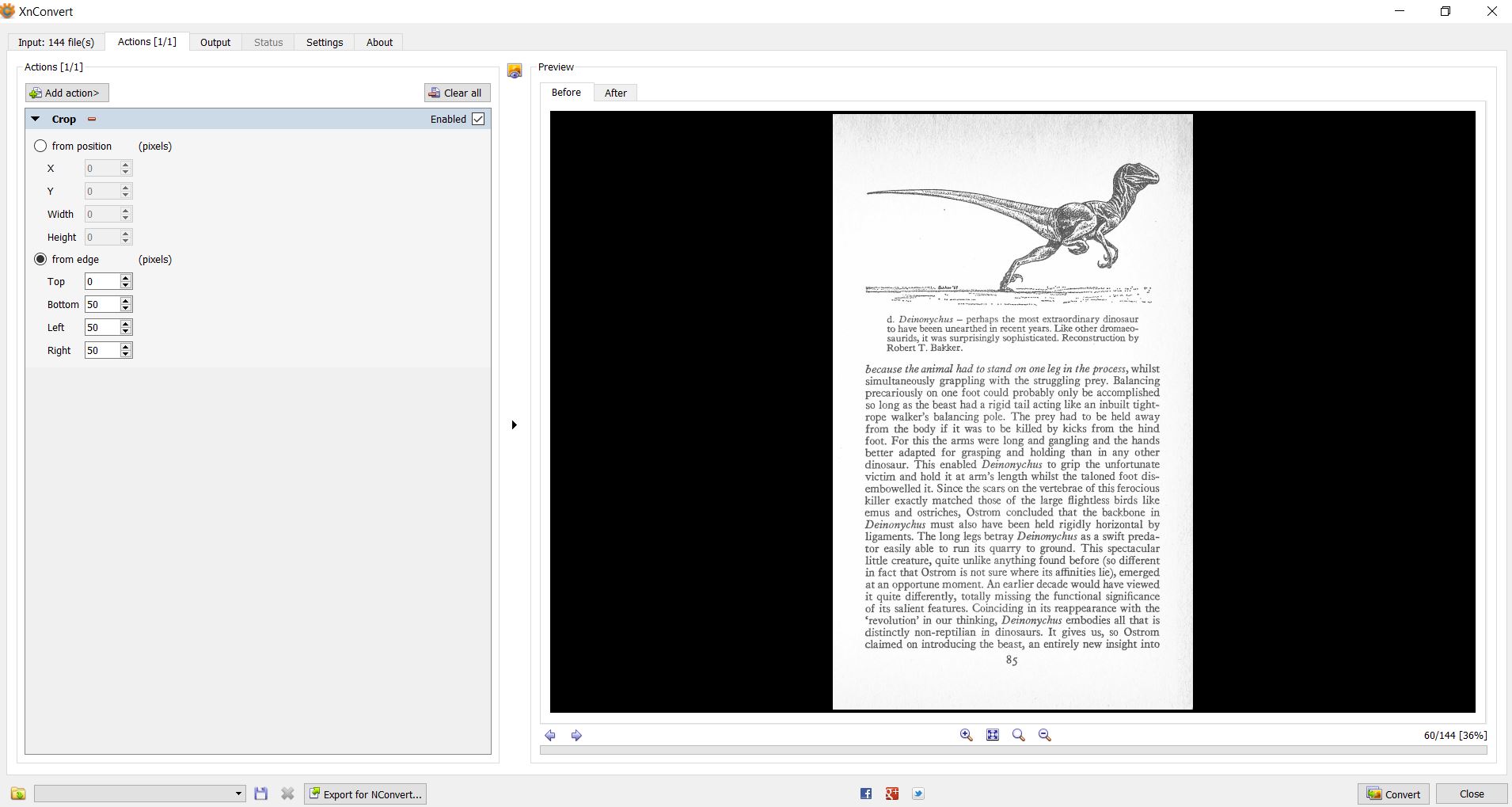

I now select the After tab. Attachment #2 shows,as expected, the cropped version. Note that the After tab is selected and that the file number at the bottom RH corner shows file number 60.

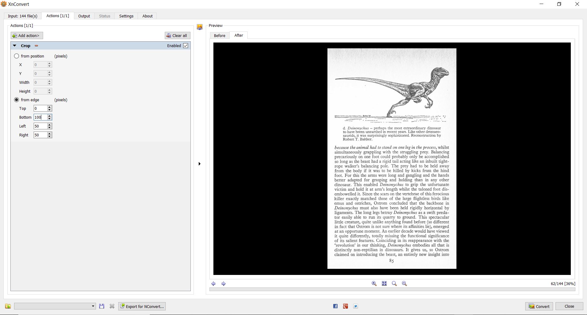

I now press the Next file arrow. Attachment #3 shows the result. The bottom RH corner shows that the file has been incremented to number 61, but the screen Preview pane has not changed.
I now press the Next file arrow again. Attachment #4 shows the result. The bottom RH corner now shows that the file has been incremented to number 62 but, yet again, the Preview pane has not changed.
