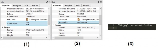

Effect: Line breaks appear properly in the image's properties in the browser, but if I try to edit them they appear as "\n" in the box. If I want to keep them as line breaks I have to delete all "\n"s and insert line breaks again.
1. Select an image in XnView MP's browser.
2. Press ctrl+D to bring up the comment editor.
3. Make sure there is a checkbox next to "Description (stored in descript.ion file)".
4. In the text box below "Description (stored in descript.ion file)" type the following:
test
test
5. Press the "Write" button.
6. Press ctrl+D to bring up the comment editor again.
Actual behaviour (bug): The text box below "Description (stored in descript.ion file)" looks like this:
test\ntestA
Expected behaviour: The text box below "Description (stored in descript.ion file)" should look like this:
test
test

I noiced that the text in (1) will change without any input from me into (2) if I exit XnView MP and open it again. My descript.ion files looks like (3) from the attached image.
Posts: 47119
Re: 0.93: Line breaks not being read properly from descript.ion
Kethus wrote: Fri Sep 27, 2019 3:01 pm I noiced that the text in (1) will change without any input from me into (2) if I exit XnView MP and open it again. My descript.ion files looks like (3) from the attached image.
your description file is good, but i can't reproduce (2)
