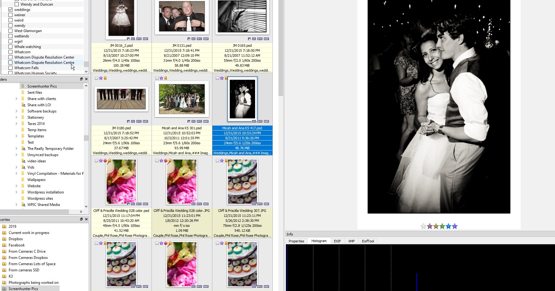

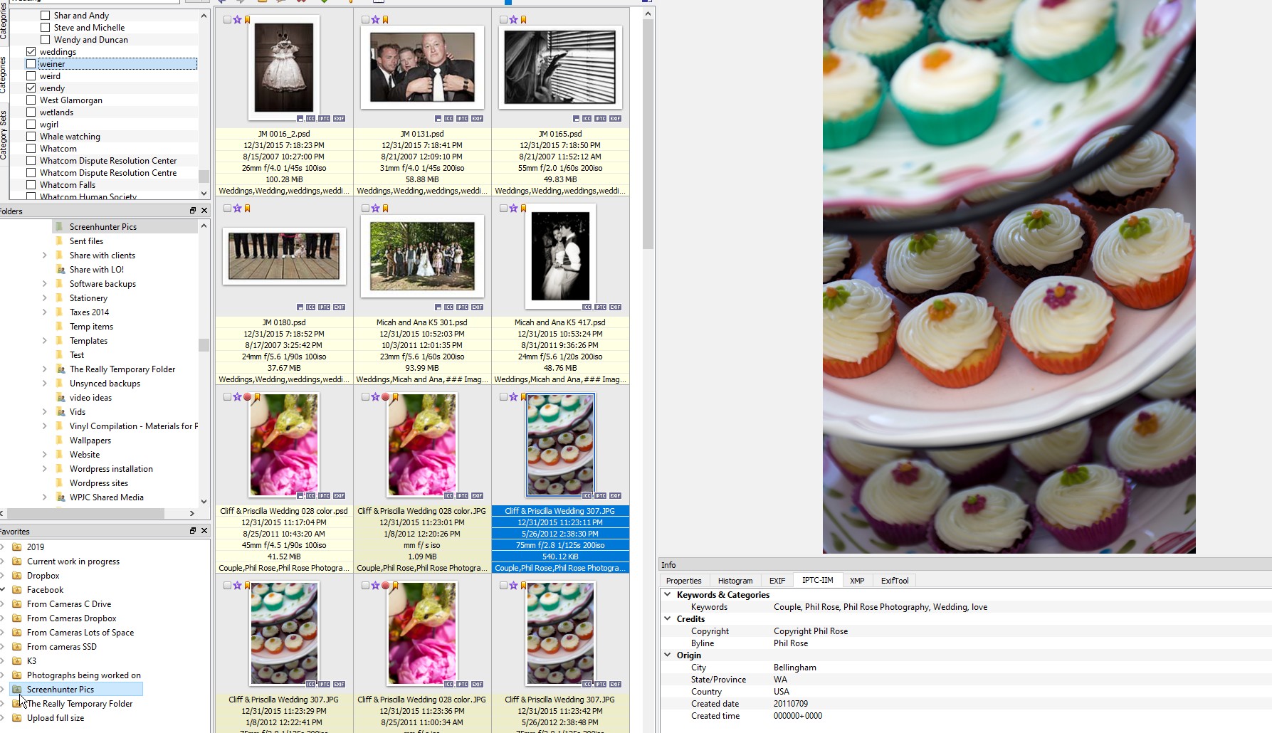

Thanks for this but it doesn't seem to be working. Please see attached screenshots. I apply a few random categories to an image, I export using the shown setting and the IPTC does not show those categories as keywords in the resultant image. Am I missing something?

https://www.dropbox.com/s/r9issrku0kqto ... 3.png?dl=0
https://www.dropbox.com/s/n7nesj7r92te5 ... 2.png?dl=0
https://www.dropbox.com/s/3s5gytmj0eyug ... 4.png?dl=0

Sorry for the incredibly slow response. I guess this got away from me. I do see IPTC-IIM tab in the info pain if it's a JPG but not a PSD (which may be expected behaviour). But I don't see the categories there, of course. I then export using batch convert (that's how I always resize and export things. Should I be using something else?) and upload to Flickr and the categories are not added as keywords which is what I hoped would happen. Any further help would be wonderful and sorry again for my slow reply.
