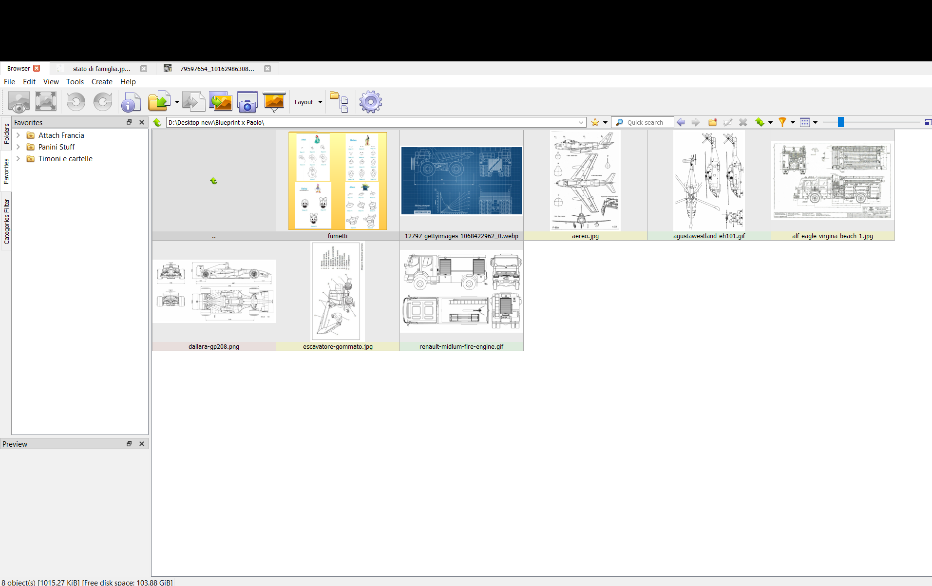

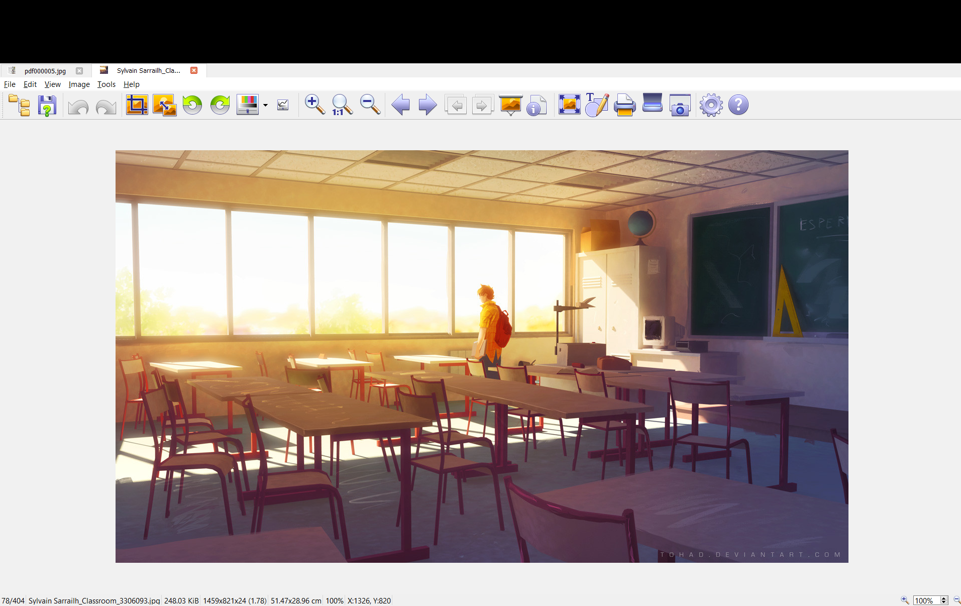

Hi, my XnView MP has been acting strangely for the last two to three days.
Whenever I open an image, in any type of visualization (fullscreen, browser) I only see the program window and nothing else, i.e no taskbar and no Nexus winstep (a tollbar I have on the right, with "above everything" setting and reserved space).
Also, I don't have the usual open, close, minimaze buttons in the top right corner.
Attached here two screenshot that shows the problems. Here there is something interesting too: you see the black bar at the top? I don't have it. It's only the screenshot (taken with the usal STAMP key) that shows it, in my monitors the program takes all the screen.
That happens EVERY SINGLE TIME I start XnView, no exception. The main problem for me is that I can't resize the window and that the taskbar is hidden, but even the rest is quite annoying too.
This is the only software I have installed in my PC that has this problem: everything else is working fine.
I'm running the program in Windows 10 home, didn't change a single thing option or add a single software before this problem came up (I may have done Windows and Office 365 update, I don't remember if I had this problem before them or not).
No taskbar, no windows controls, always fullscreen like a Windows 8 app

it seems that you have pressed Ctrl+F11 View>title bar
