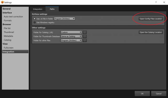

I just tried to en-/disable the pan tool successfully, running XnView MP v0.98 64-bit here. You can check the .ini-file whether the setting is available and set to false. The setting is called 'usePan' and is located in the Viewer section.
Excerpt of xnview.ini:
Check 'Settings > View > Integration > Path' to easily access the .ini-file (see screenshot).
[Viewer]
usePan=false
