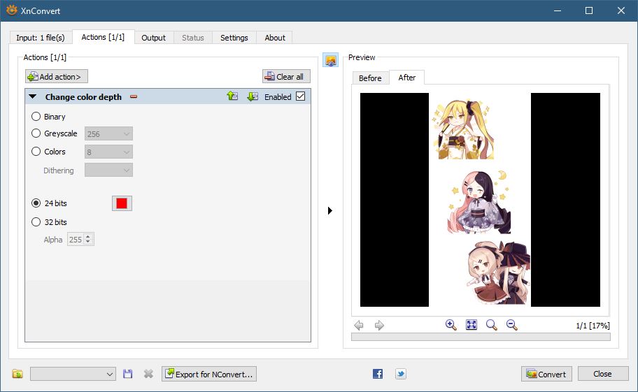

Re: Filling transparent areas with a certain color
'change color depth' doesn't work for me. Whatever color I set to replace the transparency (alpha), the output always has white as the background.
