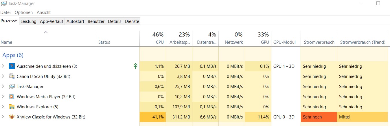

When I look at the XnView execution by the Windows Task Manager, I see that XnView Classic uses the GPU while XnView MP does not.

Windows Task Manager shows, that Classic uses the GPU while MP does not.

Strange because DirectShow codec are used in the 2 casesPh0t0 wrote: Tue Feb 15, 2022 5:22 pm Windows Task Manager shows, that Classic uses the GPU while MP does not.

See screenshots when running XnView MP and Classic with the same 4k Video.
