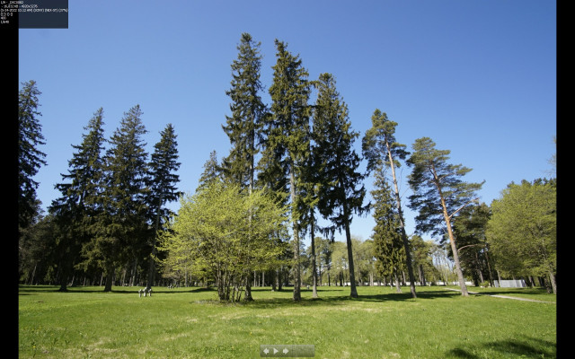

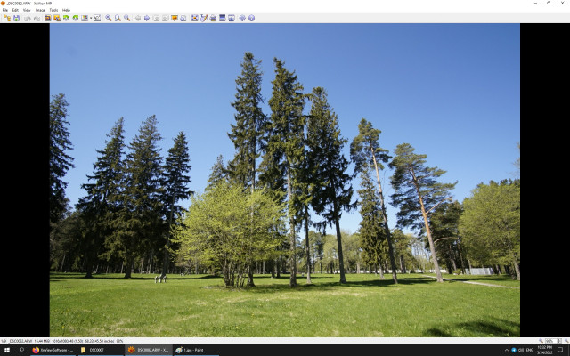

Post by FKCapitalism »
zarlan wrote: Tue May 24, 2022 4:31 pm You said you only wanted thumbnails (i.e. browser) and fullscreen …and "Viewer" is neither thumbnails, nor fullscreen, and thus clearly not a mode that you want.
If i select Browser <> Fullscreen | Viewer <> Fullscreen and click thumbnail it opens full screen with arrows on bottom.
When i select Browser <> Viewer it opens proper full screen without any distractions just as i like.
zarlan
Banned
Posts: 86
Joined: Thu Apr 14, 2022 10:33 am
Re: Disable all extra view modes
Post by zarlan »
FKCapitalism wrote: Tue May 24, 2022 7:34 pmIf i select Browser <> Fullscreen | Viewer <> Fullscreen and click thumbnail it opens full screen with arrows on bottom.
…and that stuff at the top left.
Just go into Settings - Fullscreen, and uncheck all the "Show…" options. (you can also uncheck the "Always in fullscreen" box, in Settings - View - Info, for good measure)
Then they will go away.
That is cannot, in any possible way, be referred to as fullscreen.
The image doesn't fill the screen, at all. You have the titlebar, menu-bar, toolbar, stratus bar, and taskbar, all taking up space on the screen (how are they, not distractions?), and the image only shown in the remaining space.
The image doesn't fill the screen, hence it isn't full screen.
