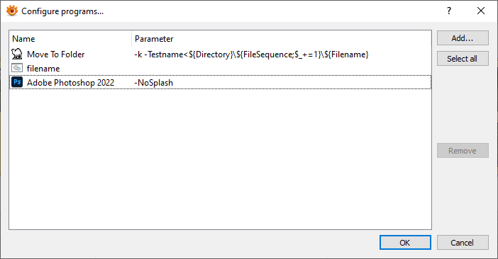

I have run into problem when i set up Open With command with Photoshop.exe command line -NoSplash and when i select image then right click Open With and select Photoshop on image that has Adobe Camera RAW adjustments *.ACR file it fails to load adjustments, only shows bare RAW image.
However when i drag and drop same file from XnView MP program windows to Photoshop it loads all adjustments okay.

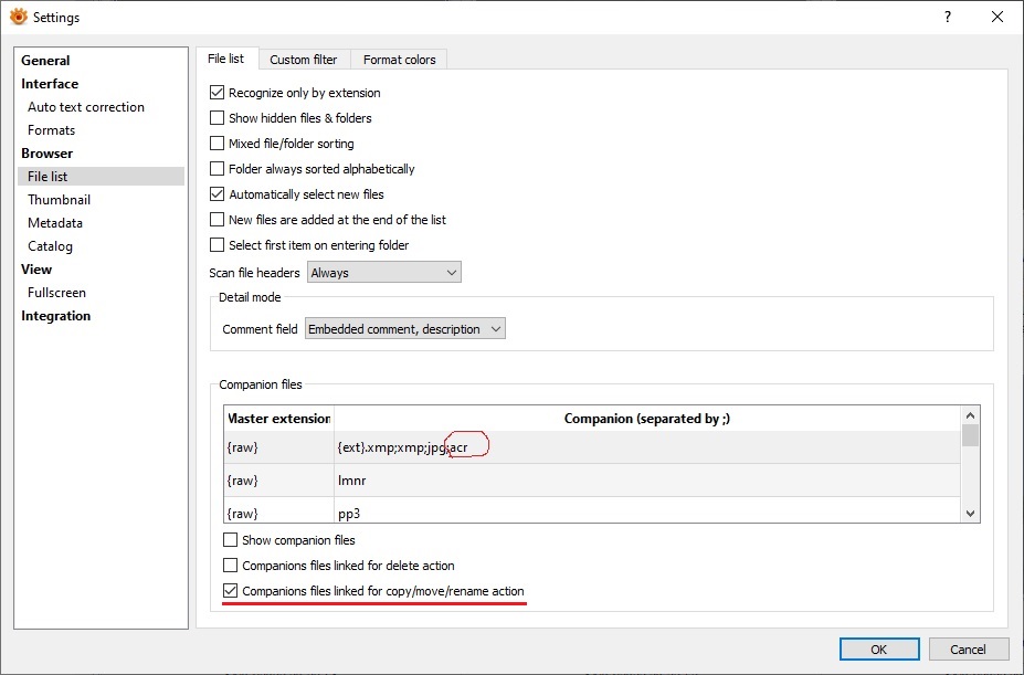

Here are my options. 2nd problem happens when i check "Companions files linked for copy/move/rename action"
When i drag this image thumbnail from XnView MP to Photoshop it tries to load ACR file as well.
1st problem happens when i right click on the thumbnail and select Open With > Photoshop
Then it opens thumbnail however ACR file located in the same folder does NOT load (Photoshop does NOT see *.ACR file so custom image settings don't update)

It's normal. When you drag&drop, 2 files will be used (selected file + companion file)FKCapitalism wrote: Thu Jul 28, 2022 5:38 am 2nd problem happens when i check "Companions files linked for copy/move/rename action"
How can we see that ACR is not loaded?1st problem happens when i right click on the thumbnail and select Open With > Photoshop

you need to disable companionFKCapitalism2 wrote: Thu Mar 06, 2025 2:19 pm 2. When dragging thumbnail from XnView MP interface to Photoshop it still shows error: Could not complete your request because Photoshop not recognizes this type of file.

This is not a great solution because if i Copy/Move files using XnView MP built in file manager companions also won't be moved?xnview wrote: Wed Mar 12, 2025 9:59 amyou need to disable companionFKCapitalism2 wrote: Thu Mar 06, 2025 2:19 pm 2. When dragging thumbnail from XnView MP interface to Photoshop it still shows error: Could not complete your request because Photoshop not recognizes this type of file.
