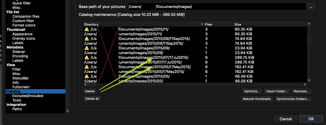

I did again export the XML list of categories via "Categories" pane, menu dropdown: "Files categories > Export", this time with selected "Export all files from catalog". Then did a "diff" with the previous XML export which shows the entries that are without categories.
I see this via "Settings > Catalog" at the "Catalog maintenance" section. There are duplicated entries with an "exclamation" icon.
(The image can be opened in a new window to see more clearly. Obfuscated the "/Users/me/Documents/" part of the paths, but the "exclaimed" and "non-exclaimed" paths are identical.)
I have not yet found an explanation of the purpose of the "Synchronize Folders..." button. Its warning is frightening.
Would a solution be to manually select each of those exclamation rows and press the left-hand "Delete" button?
