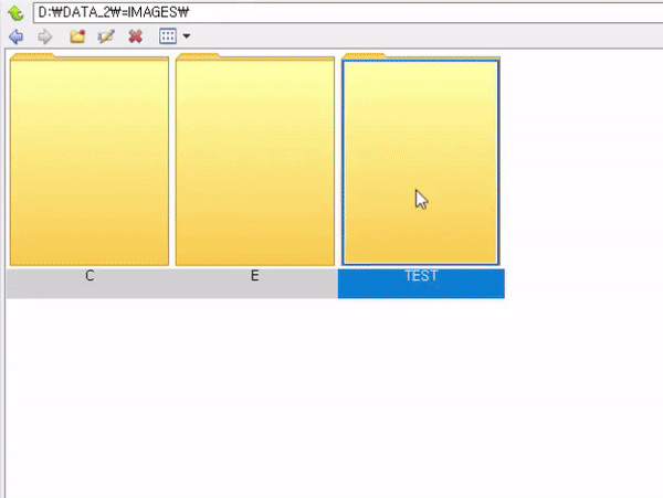

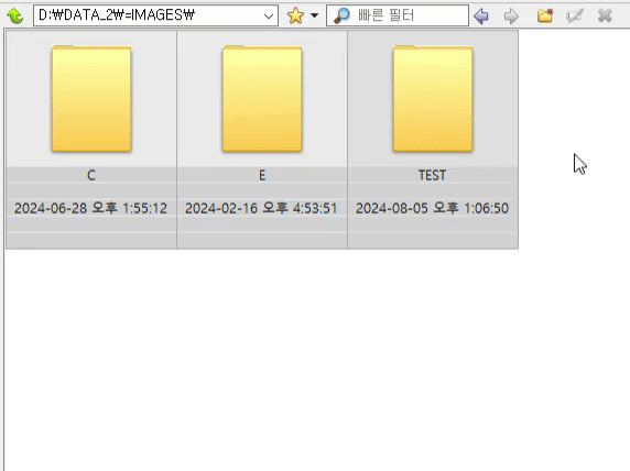

I am using XnViewMP 1.7.2.
Thumbnails are not displayed for zip files.
I used to think that this feature wasn't supported until recently.
However, I found out that cbz file thumbnails are supported.
So, I changed the name of the zip file to a cbz file to display the thumbnails.
It seems there is clearly some issue with how it works.
I am reporting this because I want the problem to be fixed.
1. When the xnview.ini file is deleted and the program is run for the first time,
customFilter=65279
thumbnailFilter=65531
Thumbnails for zip files are displayed, but if the Settings > File list > Custom filter is touched even once, the thumbnails are no longer displayed as in case 2.
2. When running with the usual settings,
customFilter=3745
thumbnailFilter=3713
Thumbnails for zip files are not displayed, but changing the file name to cbz makes the thumbnails visible.
After changing the name back to a zip file from a cbz file, the thumbnails are temporarily maintained but eventually disappear again.
Please tell me what I can do to solve this problem.
Thanks for reading.
