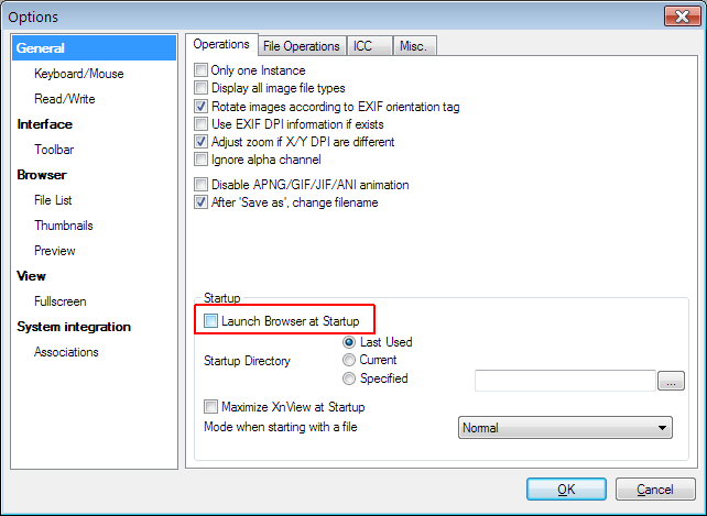

I have ver. 2.05, and have used Xnview for over a decade, and immediately replace the Windows default (now W/8.1, 64bit) with it, but in the past when i opened a pic that has XnView as the app associated with it from Windows, it would open to the view/editor, but now it opens to the browser, which means i must duplicate the action to open it. And i do not see any option ot change this.
No big deal, but i do it a lot sometimes, and would rather use Windows Explorer to open pics from.
Thanks.
Posts: 4613
Re: How to change default mode to open to view, not browser
Tools > Options...
Thank you for asking, I wasn't aware of that option until I looked and I think I could find it useful myself!
The large number of options in XnView is one of its attractions...

Thanks. I somehow overlooked that. But although now it opens to the view mode, and will show jpg, gif, bmp, etc. formats when i click on them, it will not show any jpeg pics when i do so, and instead the program just loads but with no image, but it will open them up from within XnView.
