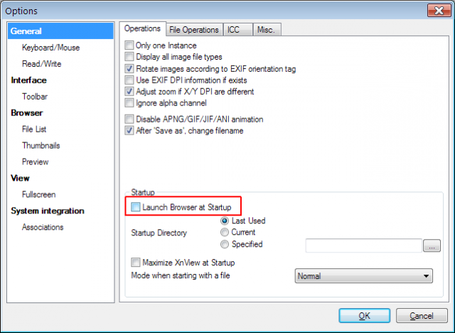

Tools > Options...
Thank you for asking, I wasn't aware of that option until I looked and I think I could find it useful myself!
The large number of options in XnView is one of its attractions...
