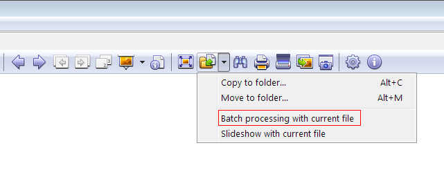

You can perform a batch operation on the current image open in the Viewer using the following icon on the toolbar:
... which opens this window with the current file already loaded; you can load the batch settings from a saved script as oops66 says but I'm not sure if the last script used loads automatically (... possibly only an option in XnViewMP and XnConvert, which you might look at if you haven't done so already. EDIT: Currently only in XnConvert -- Settings tab, but might possibly be added to XnViewMP later.)
It should alternatively be possible to perform the required operations directly from the command line using an NConvert script in a batch file .bat if all the required operations are supported.
