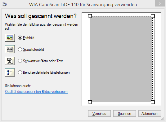

I'm using Windows 8.1 Update 1, the "Windows driver" is the original WIA driver installed by Windows (see wia.png) with limited options.

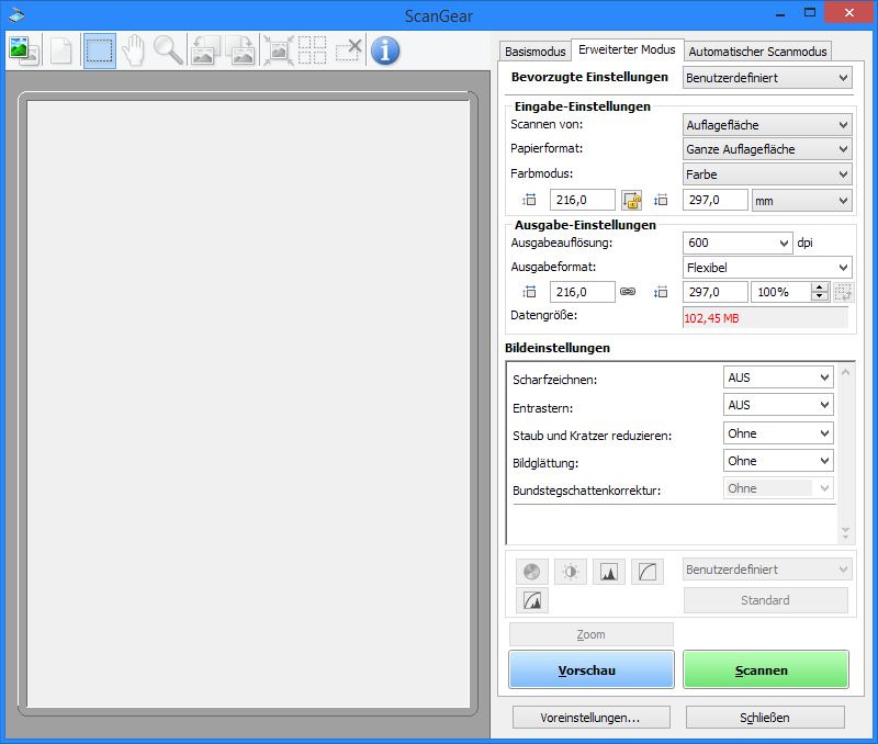

The driver I'm missing after installing 2.22 in the twain sources is the Scangear driver from Canon (see scangear.png) which is version 17.0.4.

just tried it: Both entries are shown in XNViewMP 32 Bit. Scangear works without problems.

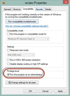

Instead of right click and choose "Run as administrator" every time, there is a way to change it permanently by going to the exe file properties and check the "Run this program as an administrator" in the compatibility tab.
Look at the attached Picture.
