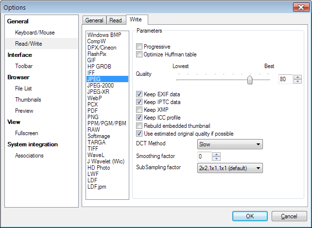

If you are opening the images in XnView Classic and then saving them, the compression used is set in the dialog displayed when the Options button in the save dialog is clicked:

To minimize so-called generation loss associated with the JPEG format, it usually is recommended to resave the image with the same settings that were used when the file was created.
The most important settings are quality factor (ranging from 0 to 100) and chroma subsampling.
