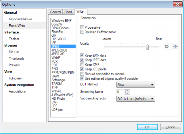

If you are opening the images in XnView Classic and then saving them, the compression used is set in the dialog displayed when the Options button in the save dialog is clicked:

If file size is a consideration, your best option is probably to experiment with saving the edited images at different JPEG compression levels, as explained in my first post, and assess the quality of the images obtained. Depending on the intended use of the edited images, for example viewing on a screen when screen resolutions may increase in the future, or printing possibly at a large size, you may want to be conservative and leave some margin, and you may wish to archive the original large files in case they are ever needed again.

To minimize so-called generation loss associated with the JPEG format, it usually is recommended to resave the image with the same settings that were used when the file was created.
The most important settings are quality factor (ranging from 0 to 100) and chroma subsampling.
