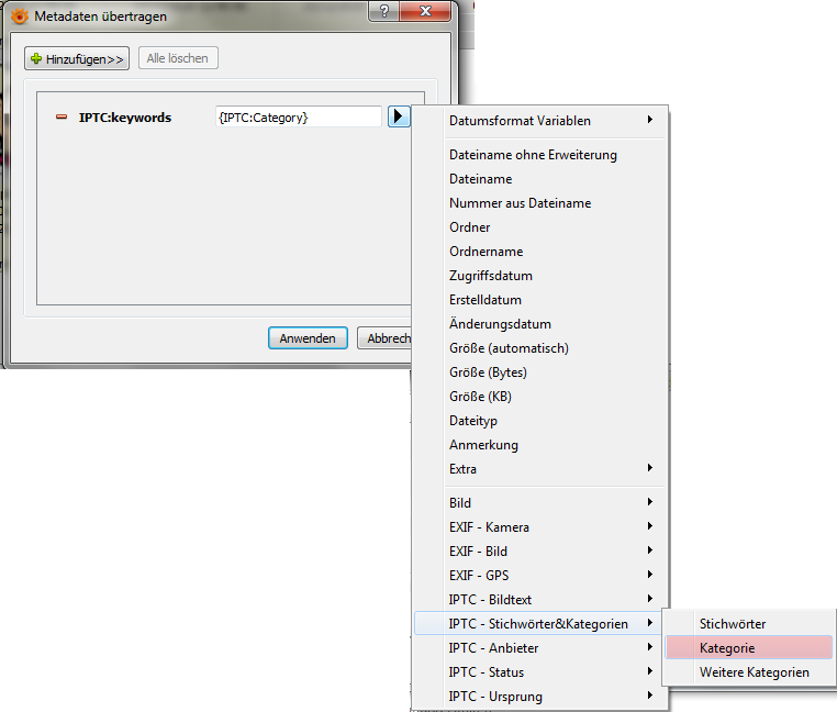

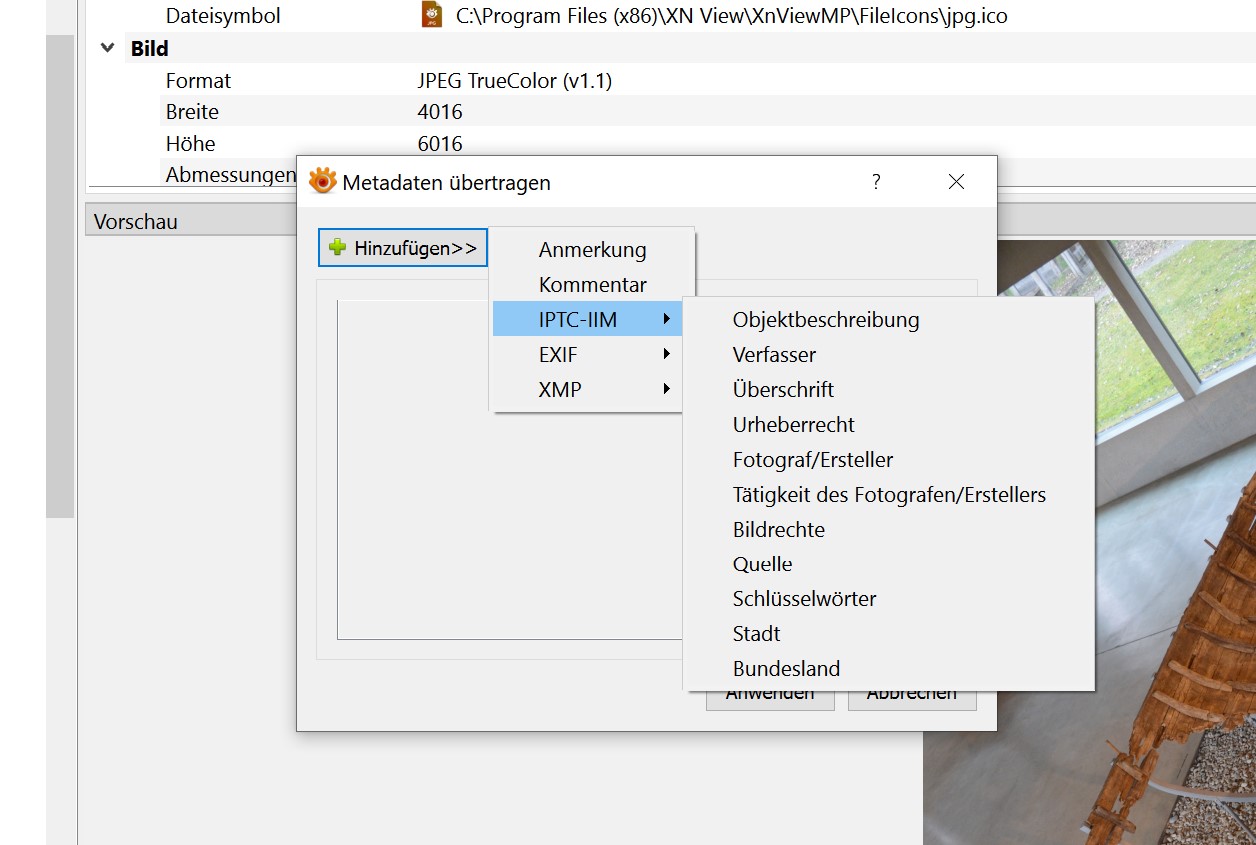

- Posts: 1525
Re: Categories and tags
If you have a lot of photos having an "iptc:category" field used,
you should perhaps consider the usefulness of copying this data into a new, relevant and more commonly used field ?
Select a test photo
Tools>Metadata>Transfer...
choose a target field, "iptc:title" for example (or any other field ?)
select iptc category as source
Apply
If it's useful, select a bunch of photos, and so on ...
if you have thousands, you can use "View > View files in subfolders" to select a big set ...
Select a test photo
Apply

Coldie67
- Posts: 7
- Joined: Wed Feb 09, 2022 9:24 am
by michel038 » Wed Feb 09, 2022 10:51 pm
2) Category
- An old iptc metadata is called category.. Almost nobody uses them anymore. (just me maybe
From 2013 on I just worked with XN View and there with categories in IPTC, and all are written in the IPTC. But Adobe does not detect.
iptc:categories is a 3 characters field that was used by associated press.
Are you talking about the one you can display in "edit iptc" window , kategorien ?
Exactly.
Perhaps some recent Adobe softwares won't show this field anymore ?
It is adobe PE 22 - does not show it - right
If I do that in Adobe and then import the files they are written in IPTC keywords...
to find a way to select / filter categories and keywords...
there is in the IPTC Fields a folder called "Schlüsselwörter (german) / keywords" - if I import the keywords from Adobe PS Elements they are shown there.
Right
IPTC:keywords (or XMP:subject as well ) is the standardized way to save embedded keywords in files.
Any software should be able to read and write these keywords.
I tried and that works (transfer from XN View to Adobe PE)
"Import folders" button in XnViewMP is used when keywords are written by another software, in order to build the internal database (Catalog)
Then, you can use "Categories filter" pane, and select items to display corresponding photos.
Got it.
XnViewMp "Settings >Metadata > Export options" are used to enable keywords writing into embedded metadata as standard method for saving keywords.
I never did before but all the "categories" are saved within the IPTC files (as well as the star evaluation)

This is exactly what I would like to do, because if I would like to use my given "categories" in Adobe PE I Have to do transfer this informations to keywords. So I would be able to work with my photos from the past
Select a test photo
Apply
And here is my problem: IPTC Category I can choose as source but then I have to fill in which category - this I do not understand. Maybe I am wrong?
That would be wonderful, but so far it is not working for a single photo ...

Sorry mistake:
Select a test photo
Apply
And here is my problem: IPTC Category I can NOT choose as source but keywords. Even then I have to fill in which keyword - this I do not understand. Maybe I am wrong?
Select a test photo
Apply

- Posts: 1525
I tried 2 kinds of iptc:categories:
First, add (+) the target field = iptc:keywords (IPTC > Stichwörter)
Then choose source field = iptc:category (IPTC > Stichwörter&Kategorien > Kategorie
Apply > it is working.
OR
Choose target field = iptc:keywords (IPTC > Stichwörter)
Then choose source field = iptc:supplemental category (IPTC > Stichwörter&Kategorien > Weitere Kategorien
Apply > it is working as well
Now, iptc keywords are ok, but XnViewMp did not update it's catalog, because "Metadata > Transfer" is not a classical way to add keywords .
So you need to select again the processed photos, and click "View > Update catalog from files" (Katalog aus Dateien aktualisieren)
"XnViewMp Categories" corresponding to new keywords will appear in Categories pane and in Categories filter pane ....

Dear Michel
thanks a lot!
I tried again and it worked. What I had to change was not to use "Kategorien", instead of that I had to choose as source field "Weitere Kategorien".
Now I could find it in the keywords.
Means for me the I can work along possibility 1) and that means that I can use all the "weitere Kategorien" as keywords in Adobe PS Elements.
Just to make it sure: for that I do not have to actualize the catalogue - right?
Thanks again, that was really a great support, you made my day.
