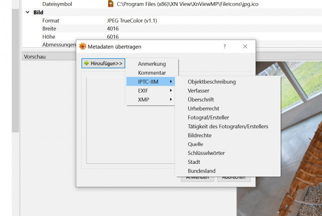

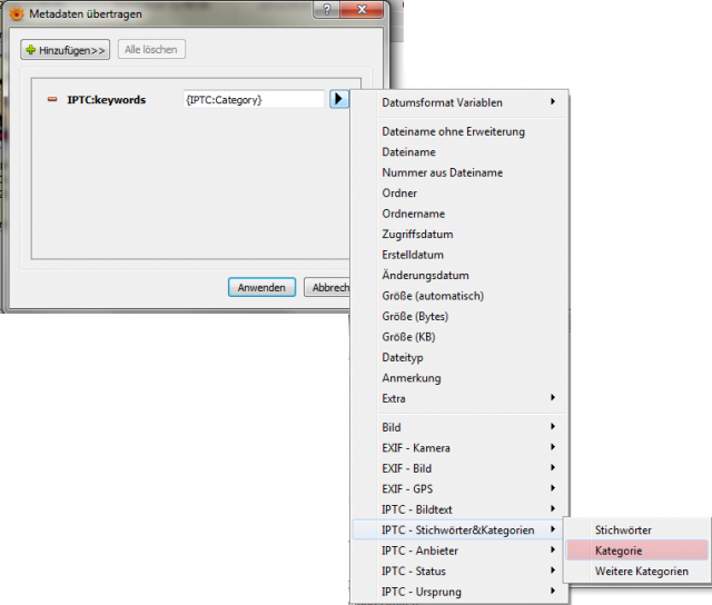

- Posts: 1588
Re: Categories and tags
If you have a lot of photos having an "iptc:category" field used,
you should perhaps consider the usefulness of copying this data into a new, relevant and more commonly used field ?
Select a test photo
Tools>Metadata>Transfer...
choose a target field, "iptc:title" for example (or any other field ?)
select iptc category as source
Apply
If it's useful, select a bunch of photos, and so on ...
if you have thousands, you can use "View > View files in subfolders" to select a big set ...
Select a test photo
Apply

This is exactly what I would like to do, because if I would like to use my given "categories" in Adobe PE I Have to do transfer this informations to keywords. So I would be able to work with my photos from the past
Select a test photo
Apply
And here is my problem: IPTC Category I can choose as source but then I have to fill in which category - this I do not understand. Maybe I am wrong?
That would be wonderful, but so far it is not working for a single photo ...

And here is my problem: IPTC Category I can NOT choose as source but keywords. Even then I have to fill in which keyword - this I do not understand. Maybe I am wrong?

I tried 2 kinds of iptc:categories:
First, add (+) the target field = iptc:keywords (IPTC > Stichwörter)
Then choose source field = iptc:category (IPTC > Stichwörter&Kategorien > Kategorie
Apply > it is working.
OR
Choose target field = iptc:keywords (IPTC > Stichwörter)
Then choose source field = iptc:supplemental category (IPTC > Stichwörter&Kategorien > Weitere Kategorien
Apply > it is working as well
Now, iptc keywords are ok, but XnViewMp did not update it's catalog, because "Metadata > Transfer" is not a classical way to add keywords .
So you need to select again the processed photos, and click "View > Update catalog from files" (Katalog aus Dateien aktualisieren)
"XnViewMp Categories" corresponding to new keywords will appear in Categories pane and in Categories filter pane ....
OR

Dear Michel
thanks a lot!
I tried again and it worked. What I had to change was not to use "Kategorien", instead of that I had to choose as source field "Weitere Kategorien".
Now I could find it in the keywords.
Means for me the I can work along possibility 1) and that means that I can use all the "weitere Kategorien" as keywords in Adobe PS Elements.
Just to make it sure: for that I do not have to actualize the catalogue - right?
Thanks again, that was really a great support, you made my day.
