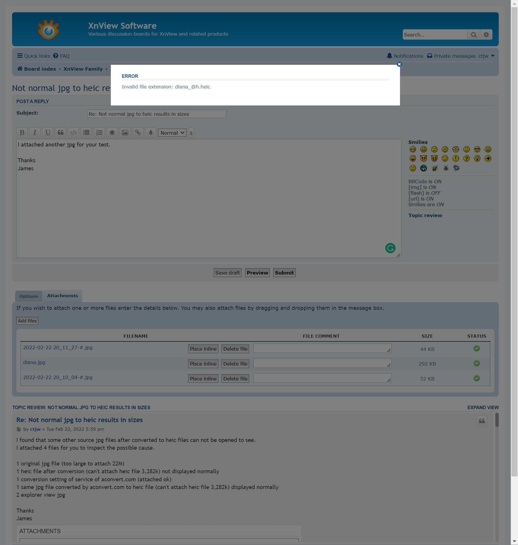

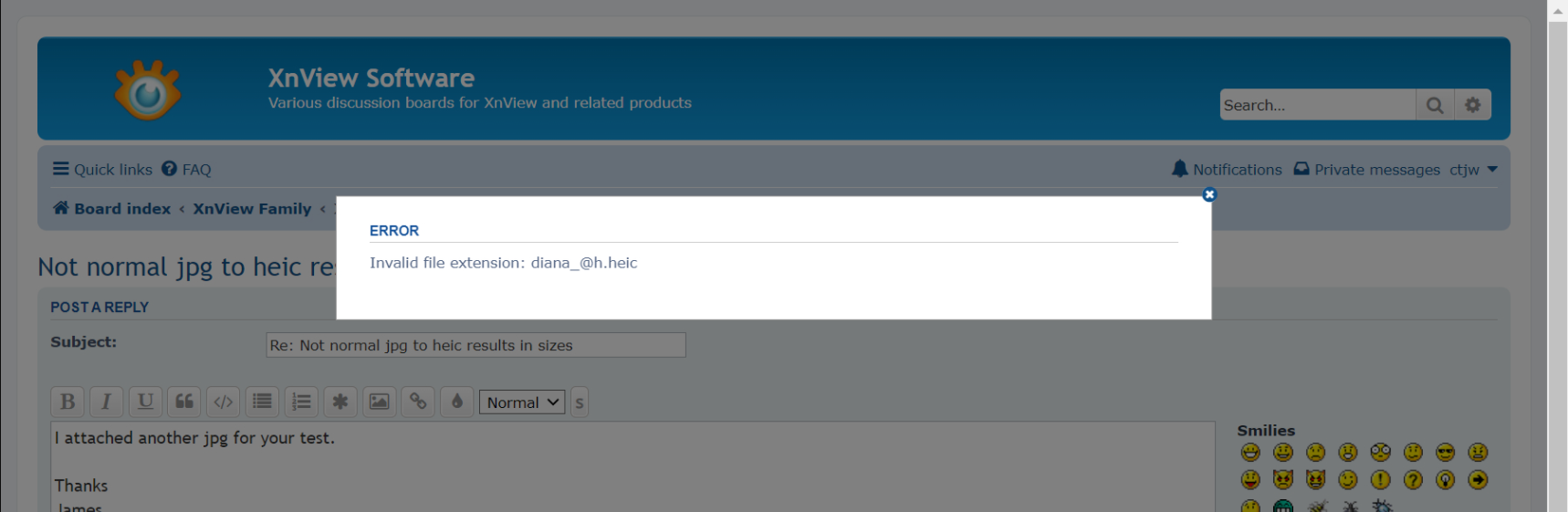

Didn't allow to submit heic file.

How about the problem that I can't post heic attachment here ?
