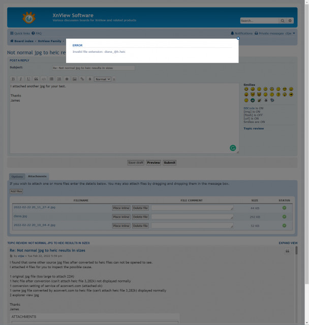

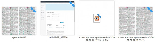

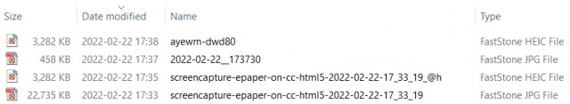

I found that some other source jpg files after converted to heic files can not be opened to see.
I attached 4 files for you to inspect the possible cause.
1 original jpg file (too large to attach 22M)
1 heic file after conversion (can't attach heic file 3,282k) not displayed normally

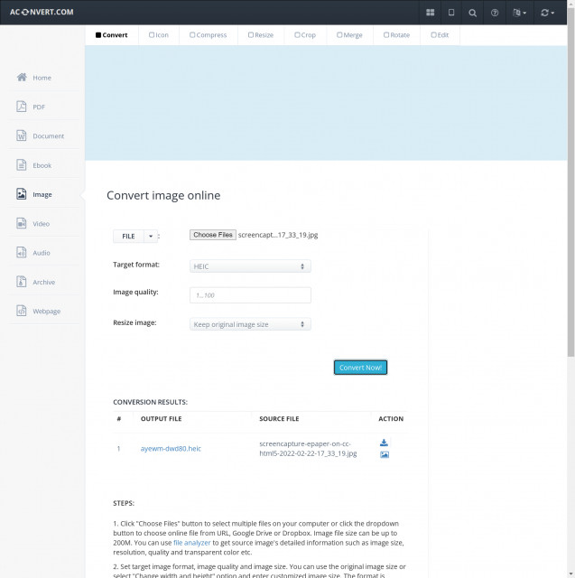

1 conversion setting of service of aconvert.com (attached ok)
1 same jpg file converted by aconvert.com to heic file (can't attach heic file 3,282k) displayed normally
2 explorer view jpg
Thanks

ctjw
Posts: 11
Joined: Fri Feb 18, 2022 5:56 am
Re: Not normal jpg to heic results in sizes
Post by ctjw »
I attached another jpg for your test.

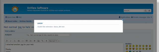

Didn't allow to submit heic file.

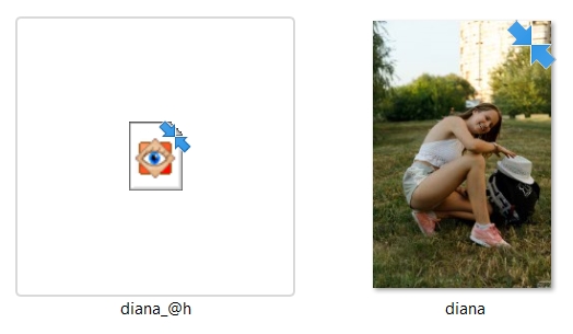

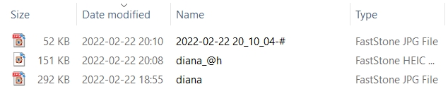

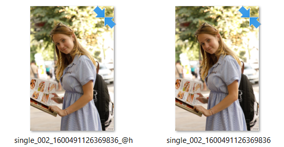

This one is shown ok using XnConvert.
Posts: 47878
ctjw wrote: Wed Feb 23, 2022 3:53 pm This one is shown ok using XnConvert.
?? sorry but i don't understand
ctjw
Posts: 11
Post by ctjw »
The one on the left is heic shown ok, the one on the right is original. It is just weird some converted heic shown ok some didn't.
How about the problem that I can't post heic attachment here ?
