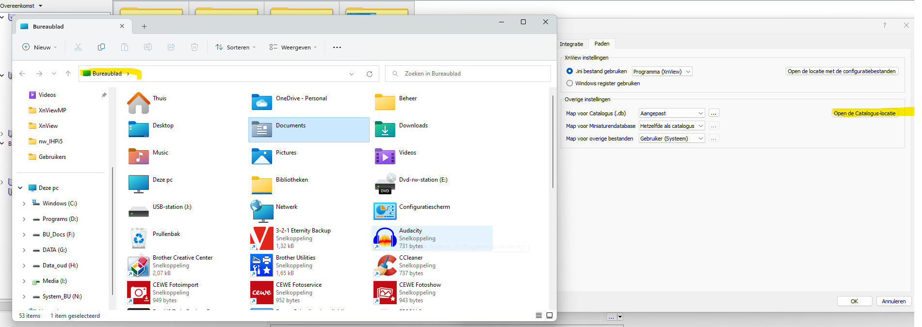

Thanks Pierre for your reactions. With the attached screenshots I'll try to describe the integration settings. My Xnview.ini is in the programsfolder (D:\Programs\XNView). My DB is on a separate partion (I:Media\Foto's\XnView\Xnview) this is stated in the settings and the correct location opens (re screenshot). However, when I click on 'open the Database location' XNview does not seem to 'recall' the location as it opens with the desktop. (re screenshot).

Following your advice I changed the location of the Xnview.ini file to the Appdatalocation. Now this location is found correctly. But would it work at all with a copy of the ini file from the old computer? Or do I have to go over all settings agian in a fresh ini file? I renamed the other Xnview files in Roaming as I prefer to have the db and Thumbs in a location that can be backup more easyly (same location as foto's). Re screenshot. Although I indicated the new location for the db (and coinsequntely thumb) in the integration settings, the db is not found (even after a save of the settings) and instead the desktop is shown as db location.

In the integration settings I can change the location of the db; but the new location is not maintained after shut down of the the program. When I click on 'open the location of the database' button in the settings screen the desktop is shown.
