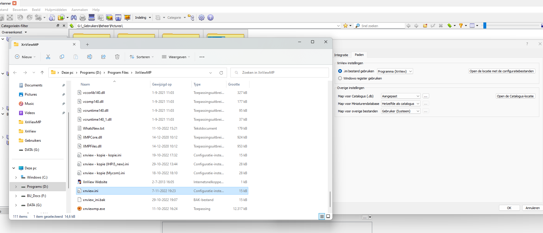

Yes, I do have an xnview.ini in the programs folder. I even tried to replace the newly created one (by the new installation of XnViewMP) with a copy from the former installation. Nothing works so far. My Xnview database is in a separate partition together with my foto's. Could you mention the files that hold my specific installation settings? I still have the old version and have not changed anything in the database after the new installation yet.

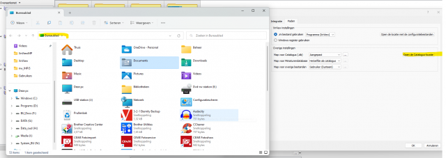

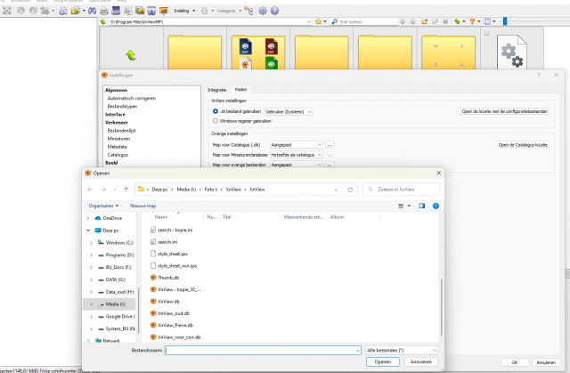

Thanks Pierre for your reactions. With the attached screenshots I'll try to describe the integration settings. My Xnview.ini is in the programsfolder (D:\Programs\XNView). My DB is on a separate partion (I:Media\Foto's\XnView\Xnview) this is stated in the settings and the correct location opens (re screenshot). However, when I click on 'open the Database location' XNview does not seem to 'recall' the location as it opens with the desktop. (re screenshot).

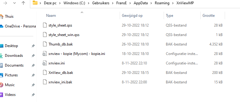

you must not have the .ini in the program folder (rights problem), but use C:\Users\...\AppData\Roaming\XnViewMP

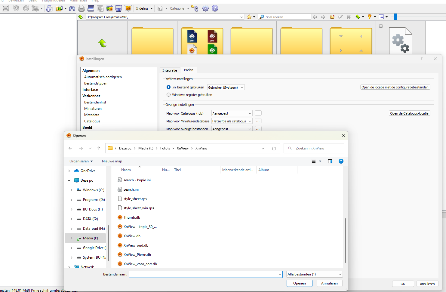

Following your advice I changed the location of the Xnview.ini file to the Appdatalocation. Now this location is found correctly. But would it work at all with a copy of the ini file from the old computer? Or do I have to go over all settings agian in a fresh ini file? I renamed the other Xnview files in Roaming as I prefer to have the db and Thumbs in a location that can be backup more easyly (same location as foto's). Re screenshot. Although I indicated the new location for the db (and coinsequntely thumb) in the integration settings, the db is not found (even after a save of the settings) and instead the desktop is shown as db location.
It seems also impossible to save the location of favourite files. These are not maintained after a program shut (via file menu).

Copying the o0ld XnView.ini wasn't enough to get the program working in W11. First I had to adjust all file references and paths in the .ini file. Secondly I had to change the location of both Thumb.db and XnView.db to the system user folder. It does not work with an ajusted folder location under integration settings. Seems strange a bit to me. So now my db file is in the W11 users file on C:\ ; not a favourite location. Do you have an explanation that the adjusted location doesn't work anymore? I used to have it under W10.

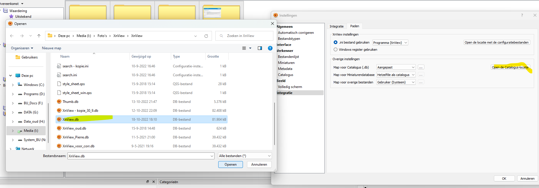

In the integration settings I can change the location of the db; but the new location is not maintained after shut down of the the program. When I click on 'open the location of the database' button in the settings screen the desktop is shown.

folder for DB is 'I:/Foto's/XnView/XnView/XnView.db/', is it good?
