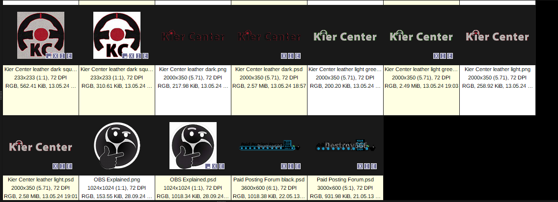

Here's an example of thumbnails showing correctly and incorrectly:
Two with white background are incorrect.

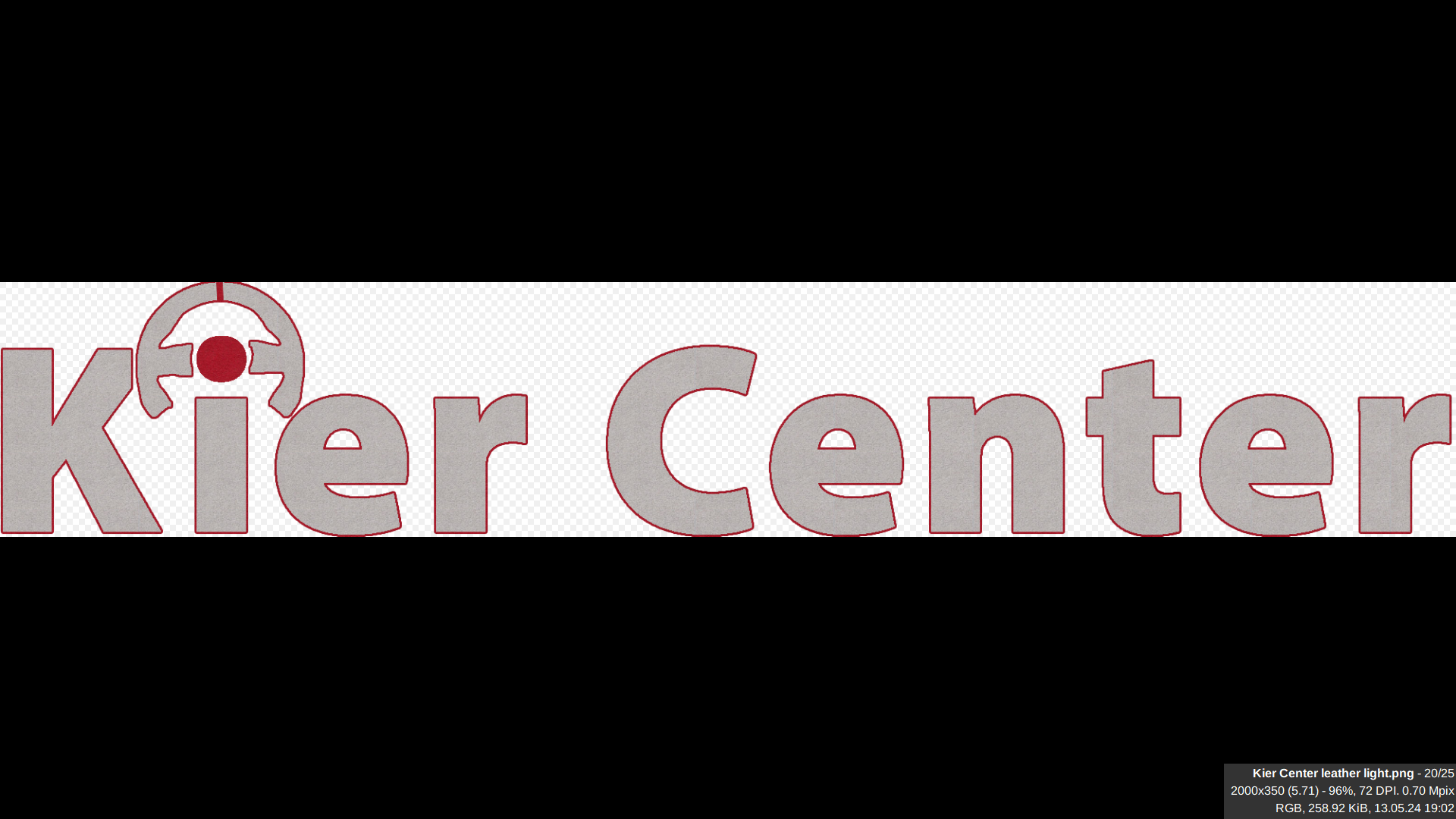

Then the previews and fullscreen of the correctly shown thumbnails have the checkerboard:
I would like to show the transparency as indeed transparency, not checkerboard.

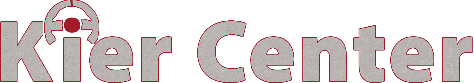

This is the image as .png, can't upload .psd which is also incorrect:

Please try deactivating Use checkerboard background pattern as background in ToolsSettings…View.

Thanks, that fixed the problems in preview/fullscreen, Not sure what activated the option in the 1st place as I had it disabled eartlier.
Thumbnails are still random in terms of backgrounds though. Is it possible that multiple geneation methods are used? I use Icaros for those normallyy.

Destroy666 wrote: Sat Oct 26, 2024 2:40 pmThumbnails are still random in terms of backgrounds though. Is it possible that multiple geneation methods are used?
This has been changes recently.
Could you please select the files in XnView's browser and then got to ViewRebuild thumbnails?

That (temporarily) fixes it but not for all files.
E.g. this PSD stays with white background: https://www.sendspace.com/file/9fral8
