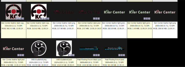

Here's an example of thumbnails showing correctly and incorrectly:
Two with white background are incorrect.

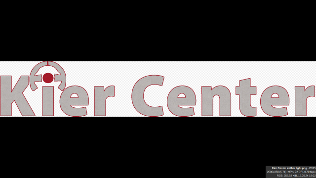

Then the previews and fullscreen of the correctly shown thumbnails have the checkerboard: I would like to show the transparency as indeed transparency, not checkerboard.

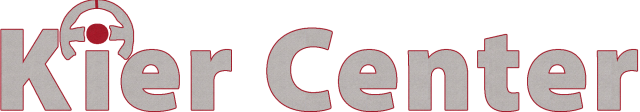

This is the image as .png, can't upload .psd which is also incorrect:

Re: Showing transparency went wrong everywhere
Please try deactivating Use checkerboard background pattern as background in Tools → Settings… → View.
Thanks, that fixed the problems in preview/fullscreen, Not sure what activated the option in the 1st place as I had it disabled eartlier.
