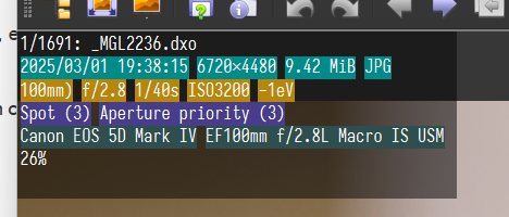

I did some custom formatting in the Info pane of View tab, encountered a minor issue regarding nested parentheses. Here's a screenshot:
屏幕截图 2025-11-11 172641.png (54.6 KiB) Viewed 387 times
Look at line 3, the focal length block has an extra right parenthesis. Here's the specific part's code:
<span style="background-color: darkgoldenrod;">{EXIF:Focal Length}mm((({EXIF:Focal Length 35mm})))</span>
What I'm trying to achieve: Display the focal length used, and if applicable, display the 35mm-equiv Focal Length in parentheses. I assume double parentheses make the field visible only if it's non-empty? So In short I want the block to look like 100mm when the 35mm-equiv FL field is empty, and 2.9mm(28) otherwise.

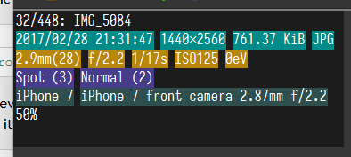

In fact, the code works when the 35mm-equiv FL field is non-empty, as shown here:

I think this is caused by wrongly parsing nested parentheses. Double parens got parsing priority so the code is interpreted as
((, (, {field}, )), )
where it should have been
((, (, {field}, ), ))
Just some speculations, I don't know how to solve it...

Re: 1.9.5: Minor Bug in Viewer - Info Pane
Posts: 47071
This problem is supposed to be fixed in XnView MP 1.9.6. Please check and confirm the bug fix here.
