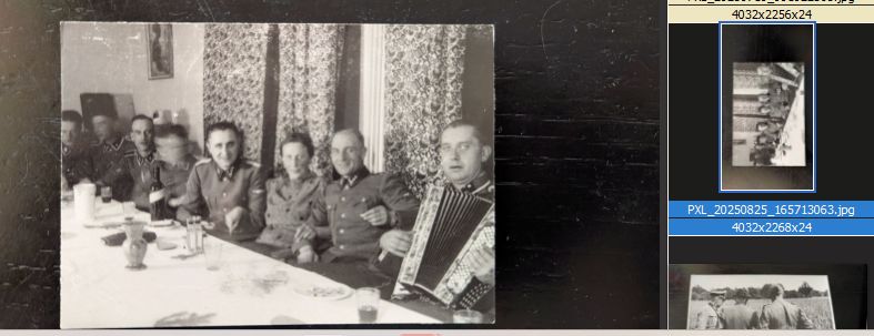

jpg rotation works super fast and well, however thumbnails remain in the wrong orientation, which makes looking through lots of thumbnails tedious.
Win 11 and xnviewmp 1.9.5
See screenshot of thumbnail after rotation: preview is great, thumbnail still upside down. Have rebuilt dbase of thumbnails, no resolve.

In my case, doing this doesn't change anything. I cannot, for the life of me, get those mis-rotated thumbnails to display properly. Here's how this still looks

Posts: 2960
Re: Thumbnails are not updating rotation
file has embedded thumbnail that is upside down, and EXIF orientation tags = 1 (Normal, 0° rotation) for both: image (IFD0) and thumbnail (IFD1)
so app has no reason to autorotate anything
you have to fix your files manually
1. select file(s)
2. fix embedded thumbnail
  • rotate
    - press 'EXIF thumbnails - Rotate 90 left' (OR right) few times in Metadata > EXIF Thumbnail
    OR
  • rebuild
    - press 'EXIF thumbnails - Rebuild' in Metadata > EXIF Thumbnail
    OR
  • delete
    - press Clean.. and select 'EXIF thumbnail' in Metadata menu

That's so awesome, thanks! The rebuild exif thumbnails worked! What a relief!
