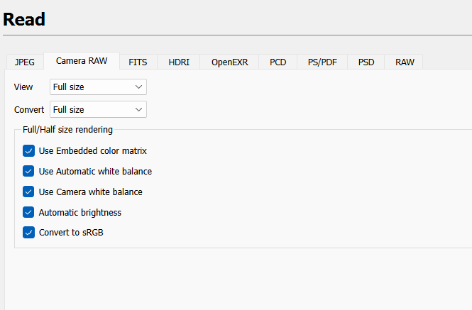

Re: Incorrect colors with .nef file display
Post by rolf smeets »
Hi, thanks for the reply. I changed settings as seen in the attachment. I had to rebuild thumbnails for this folder. This made the thumbnails look oke (=red) but the for preview, I had to check: use camera white balance. So I would think that XN does something odd.But only here in this folder. Which I do not quite understand.
