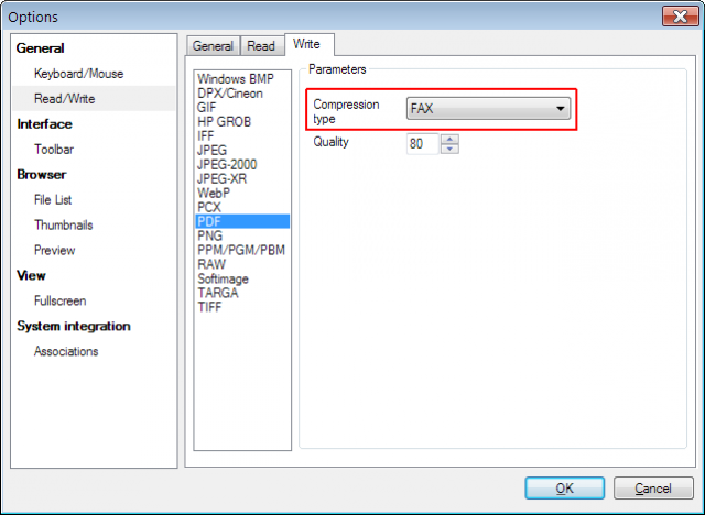

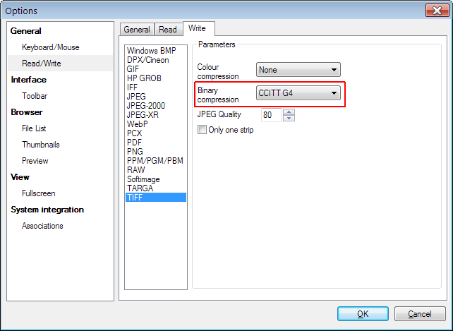

If your images are black and white the optimum compression option is 'CCITT G4' ; that is one of the 'FAX' options but XnView is slightly inconsistent in naming the options in different menus...
You likely need this setting:
If the TIFFs are small the PDF file containing them shouldn't be much larger, as the PDF format is only really a 'container' for the image(s) in the file. And if the TIFFs are black and white images with 1-bit colour depth, the 'FAX' compression option should produce a small file size.
Edit:

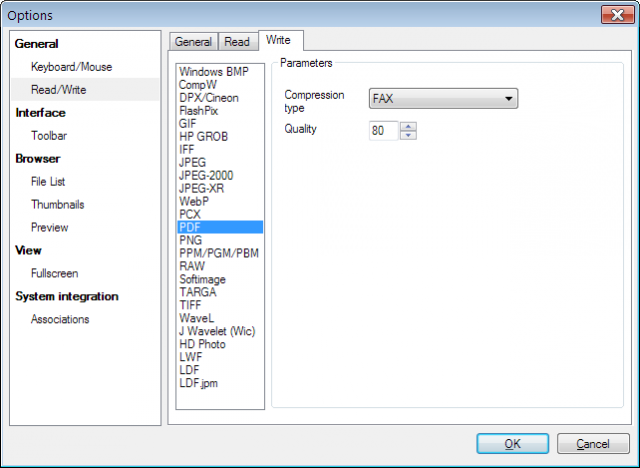

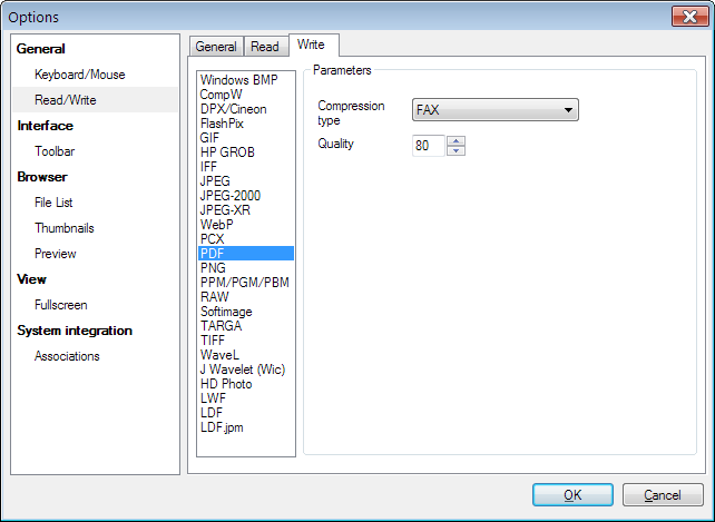

I made a screenshot with an incorrect setting, sorry about the confusion...drb wrote:... and also the screenshot of Xnview that I get when I create to get pdf looks different than yours. Why is tiff selected in yours? I thought pdf should be selected? Am I wrong?

If your TIFFs are confirmed as 1-bit colour depth as I suspect, the following save option should result in the smallest PDF file size:
Note: The 'Quality' setting is only applicable to JPEG compression, all other available compression options are lossless.

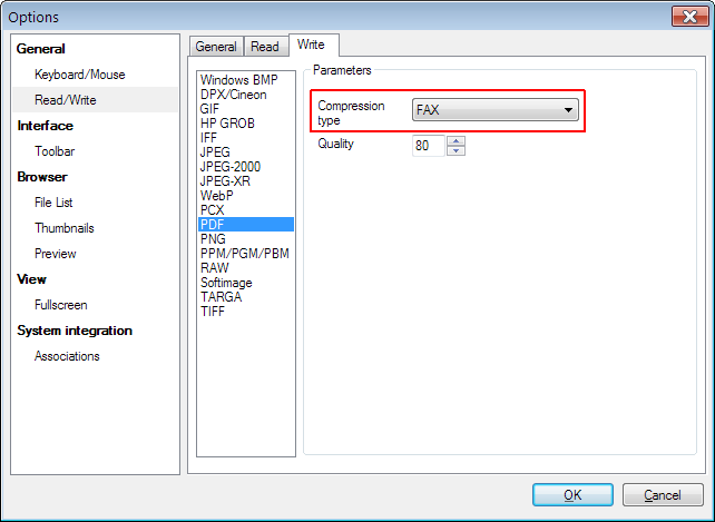

Your image was a black and white 1-bit image with CCITT G4 'Fax' encoding, as you may already know.
I've created a PDF file using File > Save as... with the file type set to PDF and Options set to FAX, as in the screenshot in my last post above.
Although the original image is now in a PDF 'wrapper' with similar compression, the file size has actually decreased marginally!
To create a multi-page PDF file use the Tools > Multipage file function with similar FAX compression.

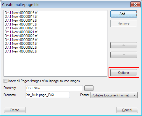

I have no problem producing a multi-page PDF of about the expected size from the TIFF files you uploaded using this method:
Tools > Multipage file > Create :
How important is file size to you, given that your images are black and white and now encoded about as efficiently as is possible using readily available freeware software? Image files are large, and if you had to scan to grayscale (necessary for any pages that have half-tone graphics or photographs) or to colour, the reulting image files even efficiently encoded would be much larger?
