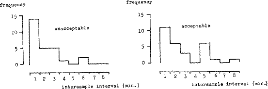

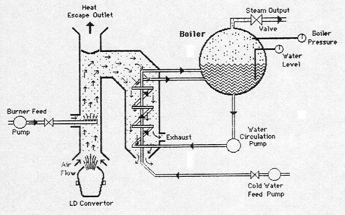

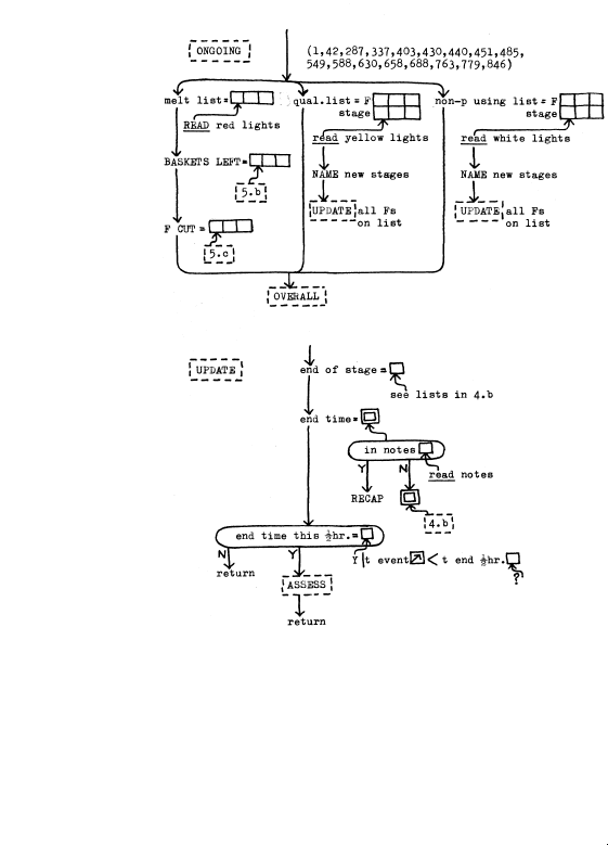

I have also have a couple of these figures in .gif format - realise they might help in identifying how PP format works.
Originals drawn before 1972, PP format versions used in 1998.
Obviously drawn by an amateur not a draughtsman, long before there were even word processors, let alone drawing or graphing software !
There's also one in .pict that I've converted to a .pdf.
