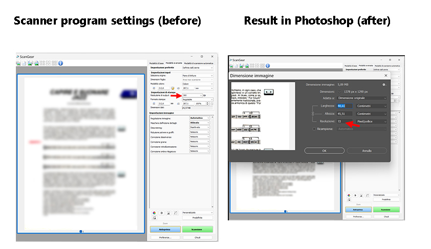

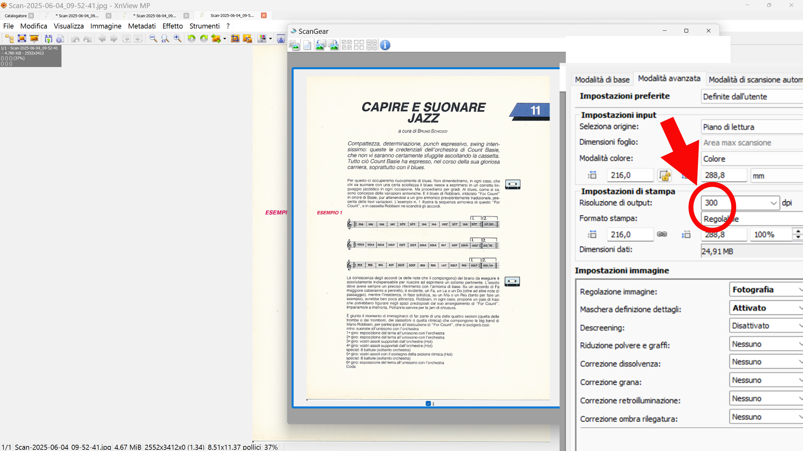

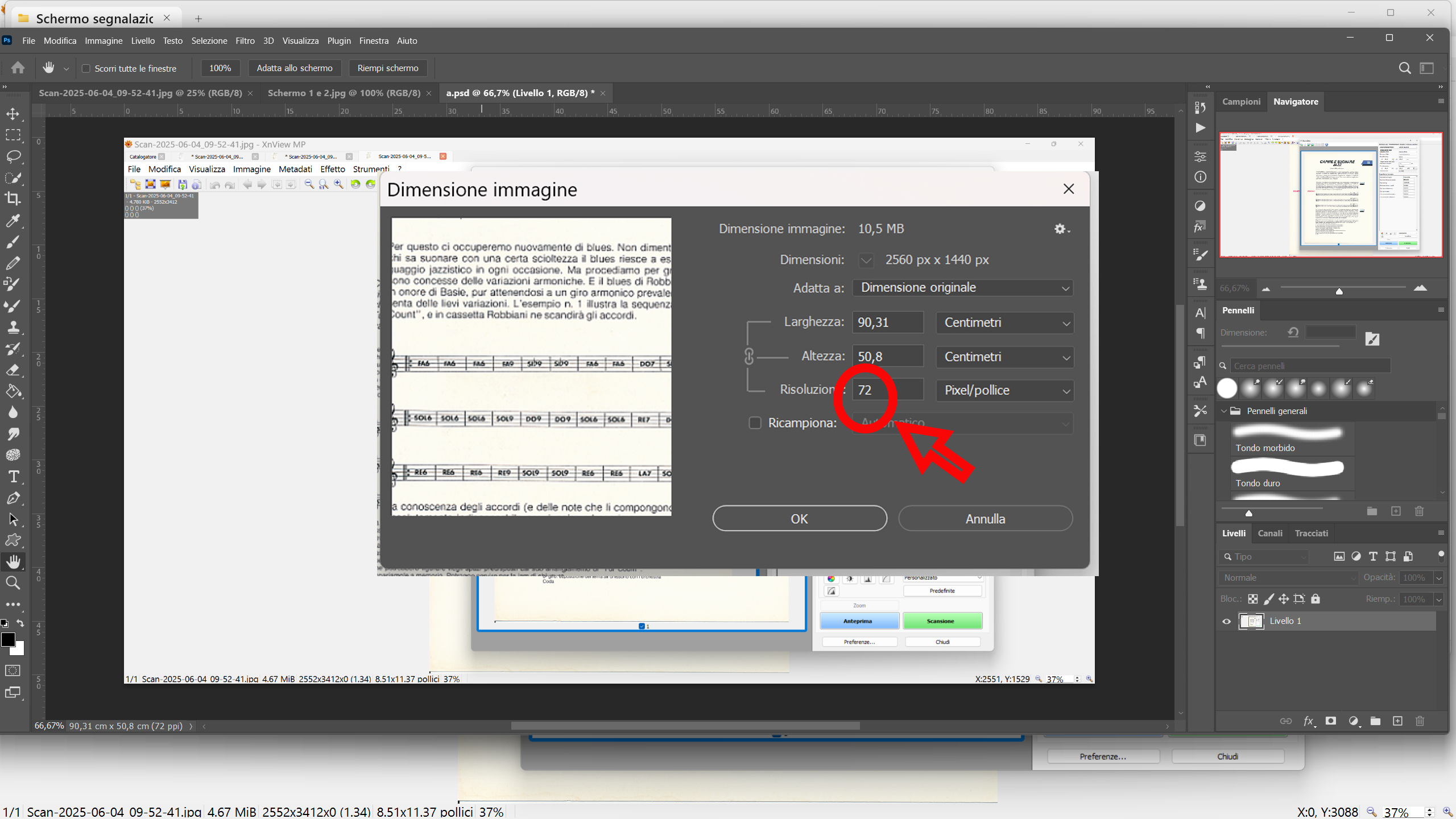

I highlighted the two boxes where, in the first, the Xnview one, the acquisition value is indicated: 300 dpi (the scan was done as a photo and not as a pdf) and in the second box, the Photoshop one, the dpi value is indicated: 72.
I don't understand why this change.
I attach two more images.

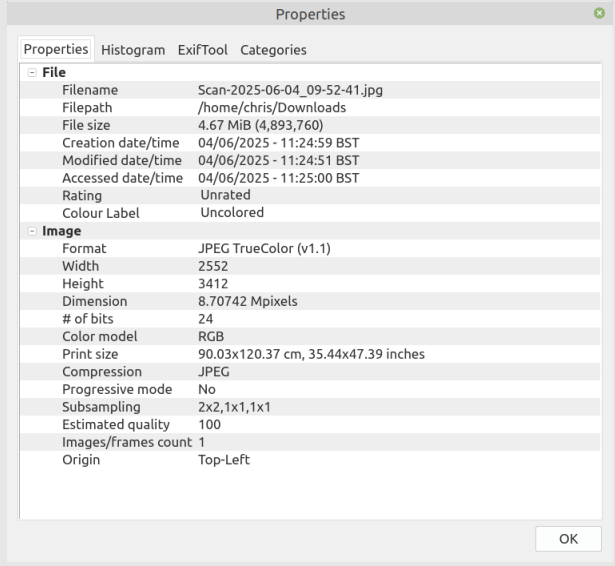

These are the properties of your image viewed in XnView MP as displayed in Image > Properties... [the 'i' icon on the toolbar]:
The DPI value isn't displayed but is in fact 72 DPI, so the value displayed in Photoshop is actually correct.
If you look at the displayed 'Print size' both the image width and height are close to 1000 cm, so the issue seemingly lies in your Epson scanner settings: if that is the file exactly as output from the scanner, I have no idea at the moment where the problem could be.
