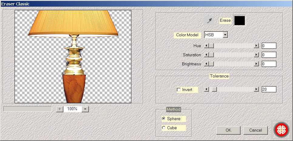

  1. Download and install Mehdi's Eraser Classic plug-in.
  2. Open 008A_1T_YA_b.jpg in XnView.
  3. Convert the image to RGBA (Image » 32 bits).
  4. Go to Filter » Adobe Photoshop Plug-In... and start Mehdi » Eraser Classic.
  5. Set the color to pure black (R0/G0/B0) and Tolerance to 20.
Here's the result I was able to achieve…
… with these settings:
As you can see, it's not perfect, and you cannot use Photoshop-compatible plug-in filters (*.8bf) in batch conversion.

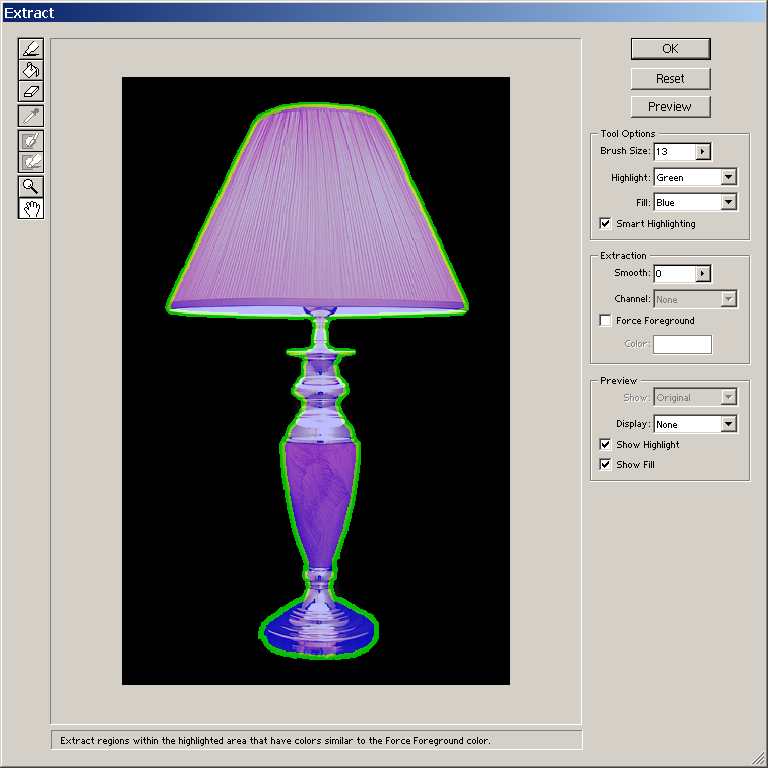

At the risk of beating a dead horse, …
… this is what's possible with the Extract tool in Photoshop v6.0.1:
