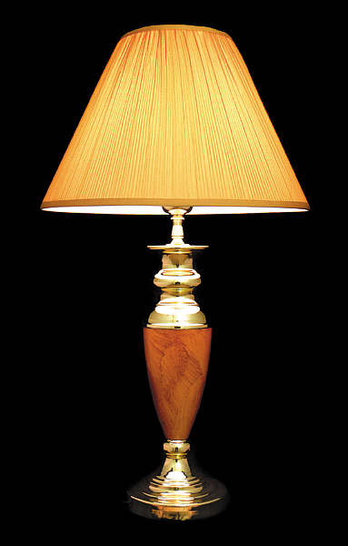

Hi guys. Im trying change background image from black to white. Its for my internet magazine. Images over 1300 in jpg format. But when i try change background over main image background stays the same.
For example: http://rghost.ru/54687939

This is not such a trivial task as it may seem (because of the compression artifacts etc.). Could you post the original/source image?

Thank you for your reply. This is original imageXnTriq wrote:This is not such a trivial task as it may seem (compression artifacts). Could you post the original/source image?
- XnView Forum
- Stack Exchange
- How-To Geek
- Remove Backgrounds Automatically with a Free Photoshop Action
- 50+ Tools & Techniques to Remove Image Backgrounds in Photoshop: Part #1 / #2 / #3
http://rghost.ru/54710788

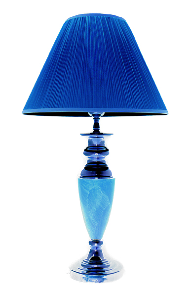

Re: Cant change background image complitly
Not so easy because your image doesn't have transparency...
Could you live with different colours?
Just joking!
[Colours inverted, black --> white with some collateral damage.]
Just joking!

I'm sorry but I'm not sure, I have very limited experience with transparency, but I noted that your image was 24-bit...soulilya wrote:If i add transparancy?
I've tried converting both the Before and After images to 32-bit, but in each case the foreground becomes the alpha channel rather than the background; I thought there might be a way of separating the image into foreground and background and then inverting the colours in the foreground again to restore the original colours, but if there is I haven't found it.
I also tried replacing black by white in the Before image (using another program) but the lamp outline is to an extent defined by the black background so that didn't work very well. But the outline of the After image seems quite sharp...
This is probably a problem for one of the outline tracing methods in XnTriq's links above, but it would be satisfying to find a direct method.

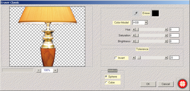

- Download and install Mehdi's Eraser Classic plug-in.
- Open 008A_1T_YA_b.jpg in XnView.
- Convert the image to RGBA (Image » 32 bits).
- Go to Filter » Adobe Photoshop Plug-In... and start Mehdi » Eraser Classic.
- Set the color to pure black (R0/G0/B0) and Tolerance to 20.
… with these settings:
As you can see, it's not perfect, and you cannot use Photoshop-compatible plug-in filters (*.8bf) in batch conversion.

XnTriq wrote: ... and you cannot use Photoshop-compatible plug-in filters (*.8bf) in batch conversion.
I'm afraid not, as Mehdi » Eraser Classic is a Photoshop-compatible (*.8bf) plug-in filter...soulilya wrote:And i can use this plug in for packet 1600 pics?
So not with XnView software, unless someone can find another way that doesn't require a *.8bf filter.

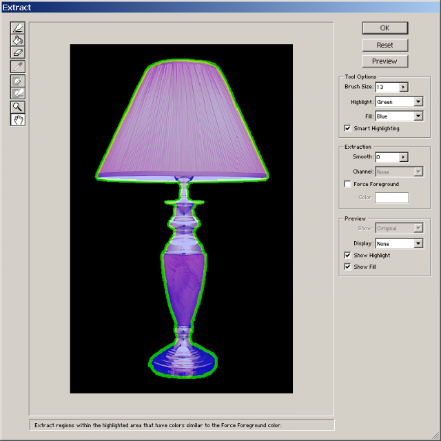

At the risk of beating a dead horse, …

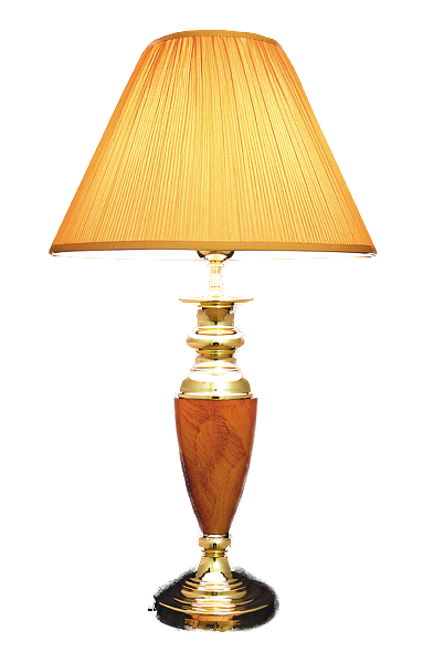

… this is what's possible with the Extract tool in Photoshop v6.0.1:
