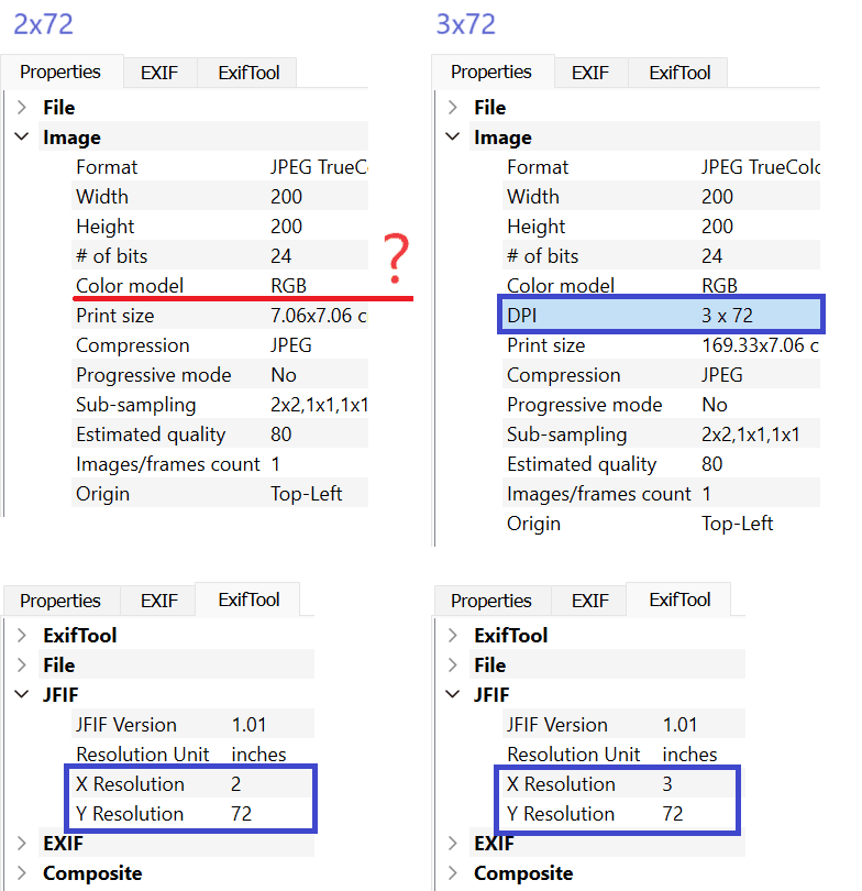

Posts: 3168
Re: JPEG Estimated Quality in Info panel 'Properties' gone? Histogram too?
There are no such issues with clean 1.7.1
try to delete xnview.ini
However, some strings may be omitted if they are too low / "incorrect", eg:
  • no XY DPI
    xnview wrote: Mon Apr 15, 2024 12:11 pm right, at loading, if dpi is <= 2, it's not a good value for me
  • no Dimension (your image on the right)
I think values that "always exists" (eg Dimension, DPI) should not be omitted even if they are close to 0.
