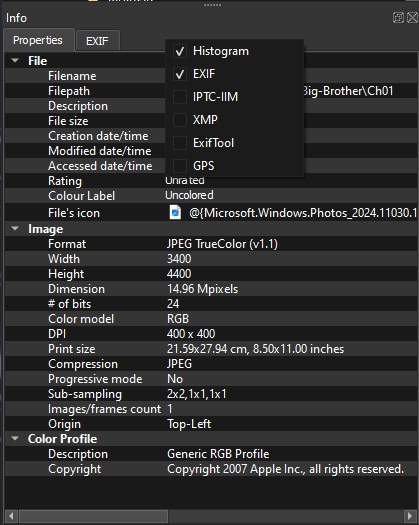

I'm not sure if this is by design, or something on my end. But since I think the last 2 or 3 updates, I no longer have an 'Estimated Quality' in the Info panel 'Properties' for JPG's.
The panel itself seems to have issues to. There used to be a Histogram panel which is now MIA.
If I right-click on the tab area of the panel, it's still listed on the context menu as item, but when I put a checkmark in front, the histogram stays gone...

FaceCrap wrote: Thu Apr 11, 2024 8:38 pm I'm not sure if this is by design, or something on my end. But since I think the last 2 or 3 updates, I no longer have an 'Estimated Quality' in the Info panel 'Properties' for JPG's.
on all jpeg?
If you try to uncheck/check?

xnview wrote: Fri Apr 12, 2024 6:05 am If you try to uncheck/check?
Makes no difference. Nothing happens when I toggle the checkmark.
Ok, Judging from your question. I'm gonna wipe it from the system and re-install.
Perhaps I left some traces behind the first time I tried.
Ok, system cleaned of all possible traces... re-installed.
Got the histogram tab back, but the panel stays empty all the time.
Estimated Quality for any and all jpg's still MIA...

No Estimated Quality
No Histogram

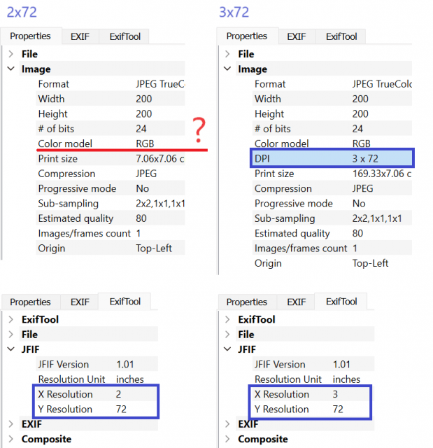

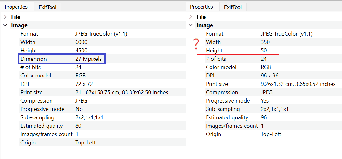

There are no such issues with clean 1.7.1
try to delete xnview.ini
However, some strings may be omitted if they are too low / "incorrect", eg:
  • no XY DPI
    xnview wrote: Mon Apr 15, 2024 12:11 pm right, at loading, if dpi is <= 2, it's not a good value for me
  • no Dimension (your image on the right)
I think values that "always exists" (eg Dimension, DPI) should not be omitted even if they are close to 0.
